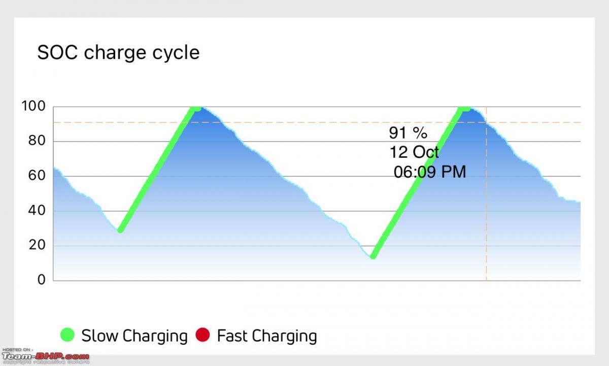

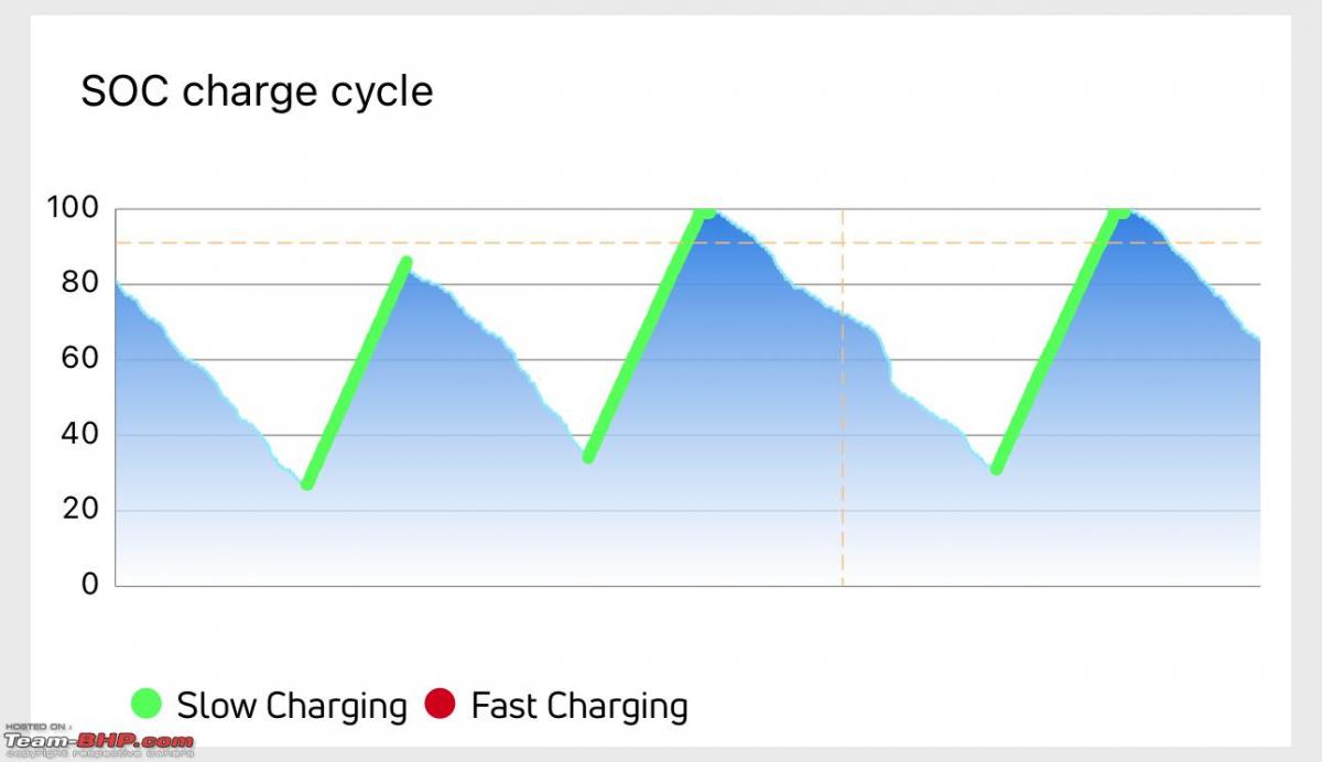

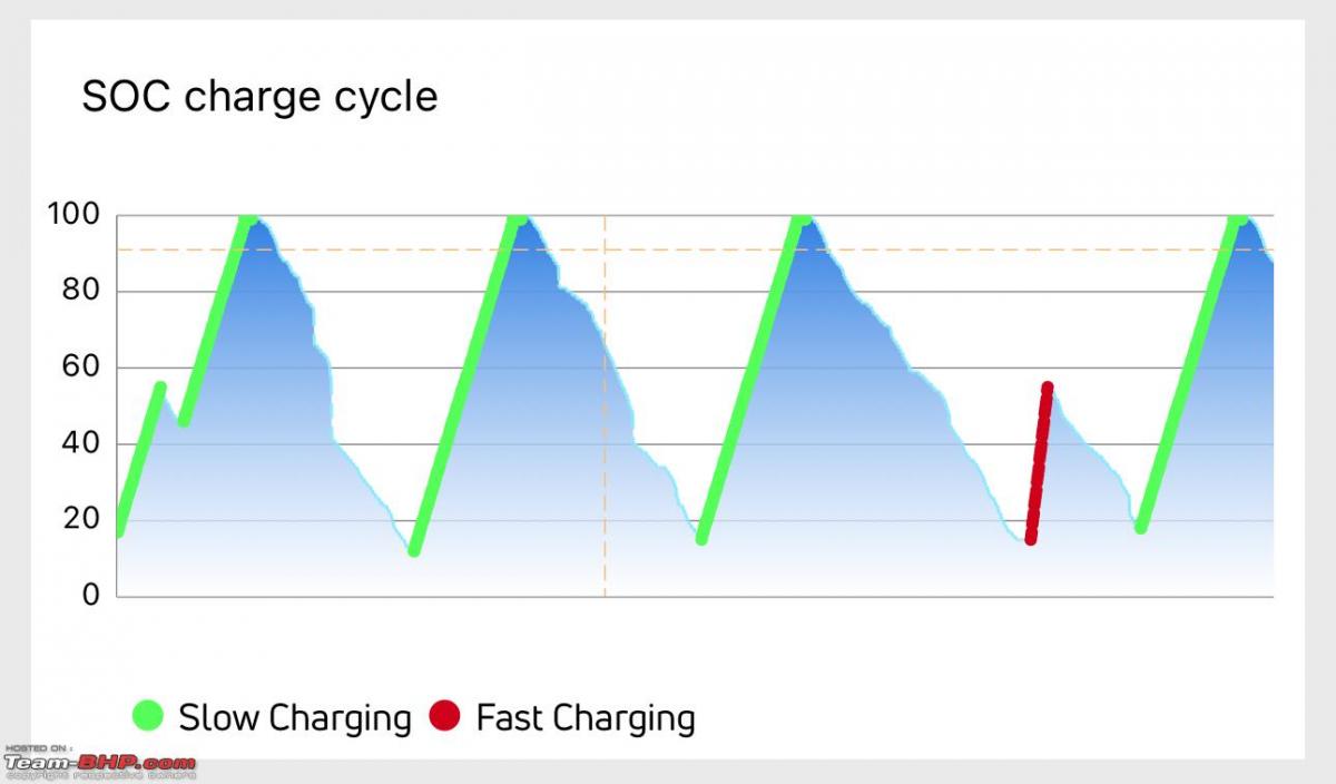

If the car is driving fine, i think it should be ok. Can you please share your charging graph/soc history from zconnect app?
BHPian krishnadevjs replied:
This is the SOC from the app, for the last 4 months.
