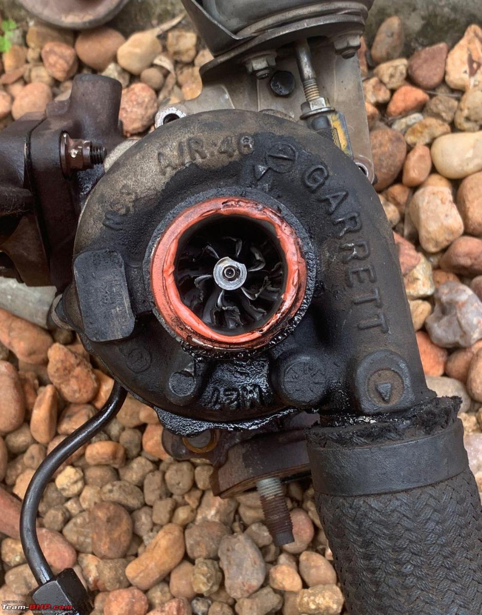

Long story short, I have it towed on a flatbed to the showroom, and the showroom guys suspect its engine failure and whatnot, and they say we would have to open it up completely, I even ask for a compression test but they don't seem to have it, I decide to take the car home and ask the engine workshop technicians to come and take a look at it as they have given me warranty on the engine work, they show up after two days and upon investigating the problem, find the turbo core has been damaged and hence blocked the exhaust and that is the reason it won't start, they inform me that it has to be changed. The Sonata Transform runs a Garrett Turbo and they have stopped manufacturing this model.
I proceeded to have the Turbo + Manifold + EGR removed at home, they disassembled the turbo and it seems the turbo shaft had broken and that is what caused the turbo to fail, the car was kept at home for about a month until I found a guy who has been in the turbo repairs business for a long time, he advises to acquire a J-Rone Turbo Core against a TLC Brazil. Anyway, I send it to him for repairs and when I go to collect it, I take along with the EGR, Catalytic Converter & Rear Mufflers, the turbo core work is done and he completes the cleaning in two hours and returns the turbo with a 1-year warranty clause.

Also, please see the relevant pics attached of the damaged turbo, new turbo core and current nut adjustment of wastegate taken two days ago.
