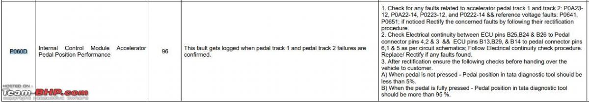

  • The scan showed P060D code - this code basically implies the Powertrain Control Module (PCM) cannot judge the Accelerator Pedal Position (APP)

Error code from the scan:
1st Update:

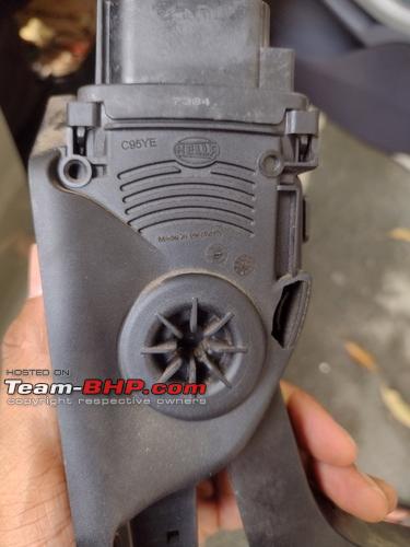

We had another mechanic run a diagnostic with the scanner. The APP reading swings from 7% to 66%, with no accelerator input to full accelerator input. He was expecting closer to the ideal 0-100% reading.
He removed the accelerator pedal and tested it on another EcoSport. Based on this he said the accelerator sensor is not faulty - I wasn't with him during the test so I am not sure what the readings were on the test car.
2nd update:
I had a chat with the mechanic about the method he used to test the accelerator pedal. He swapped it into another EcoSport and checked for error lights on the dash. He did not specifically check for the APP readings on the scanner. When I inspected the 6 pins on the accelerator pedal, it seemed to look alright. The pedal is made by Hella in Germany and costs Rs 6200 on Boodmo. It is held in place by 2 bolts and has a 6-pin connector.
