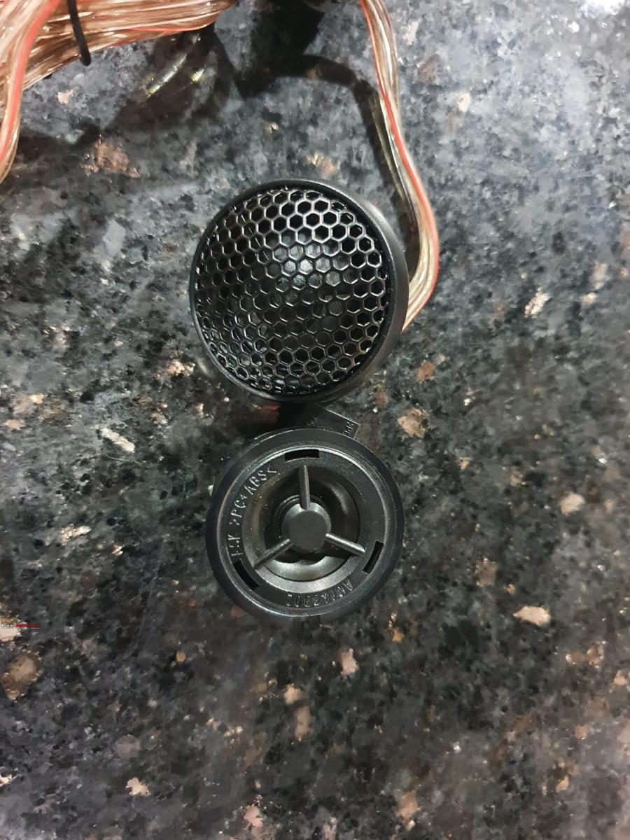

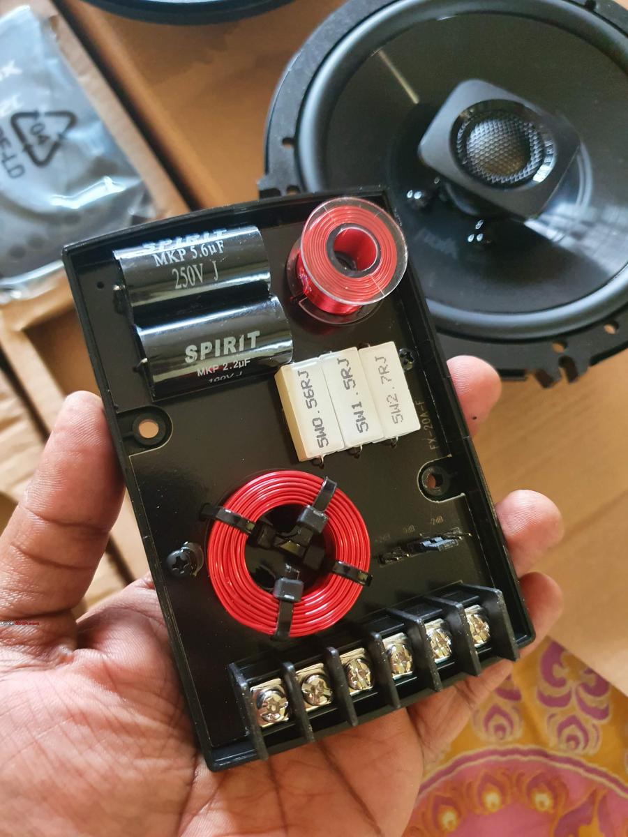

Front Speakers - Helix L62C

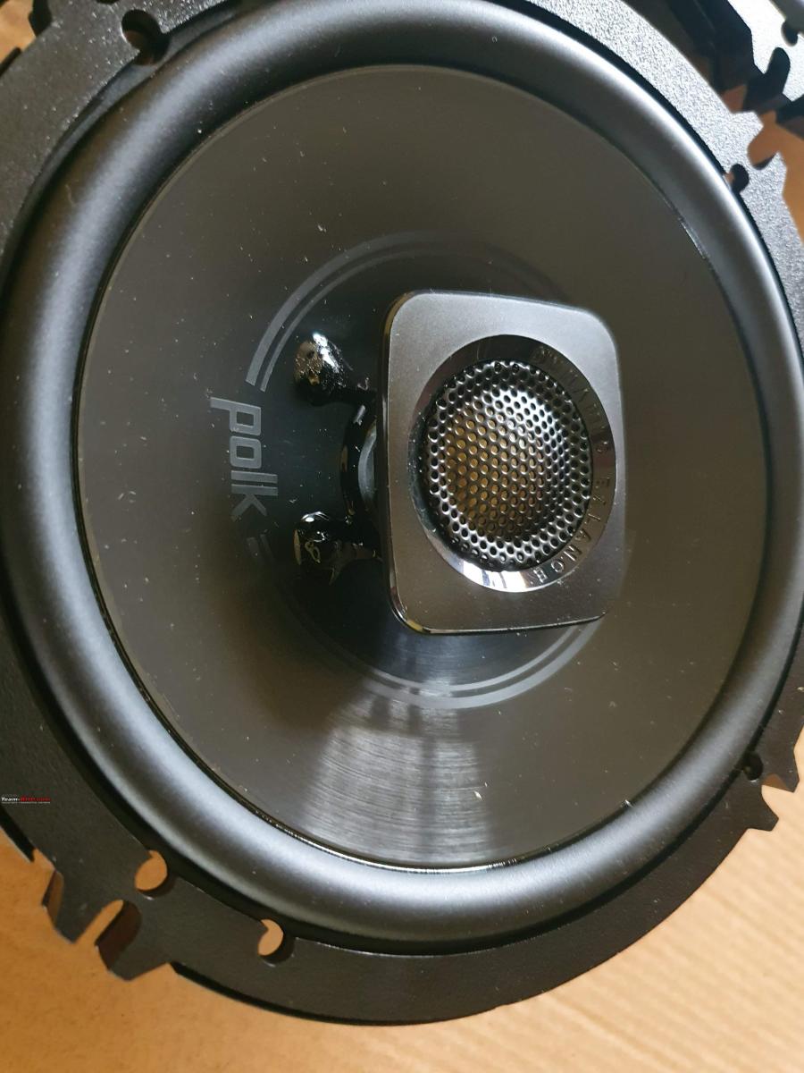

Rear Speakers - Polk DB652

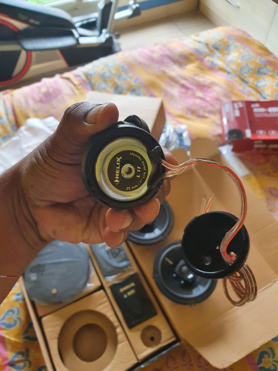

Mandatory speaker comparison pics:

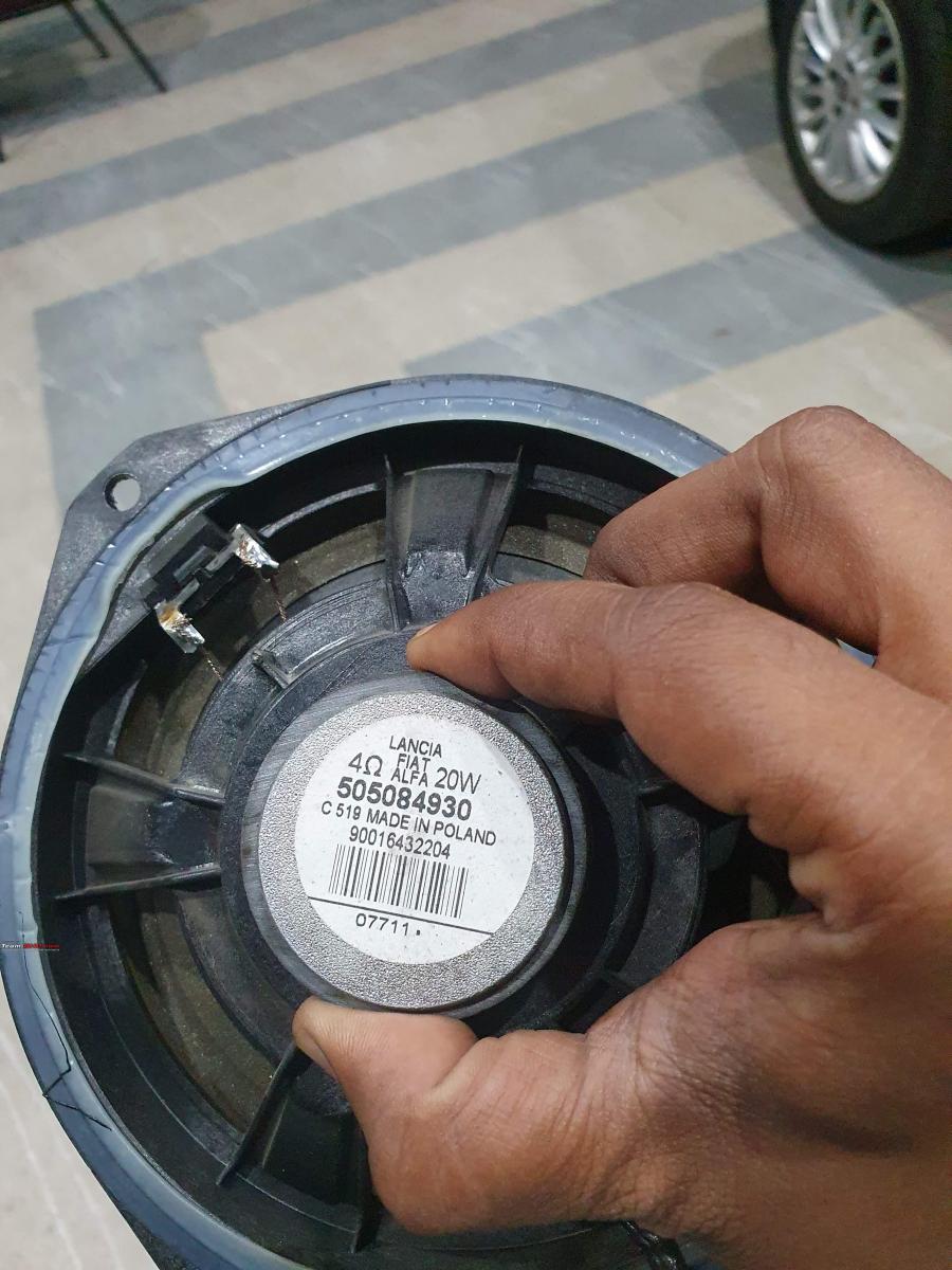

Front Stock vs Helix Components:

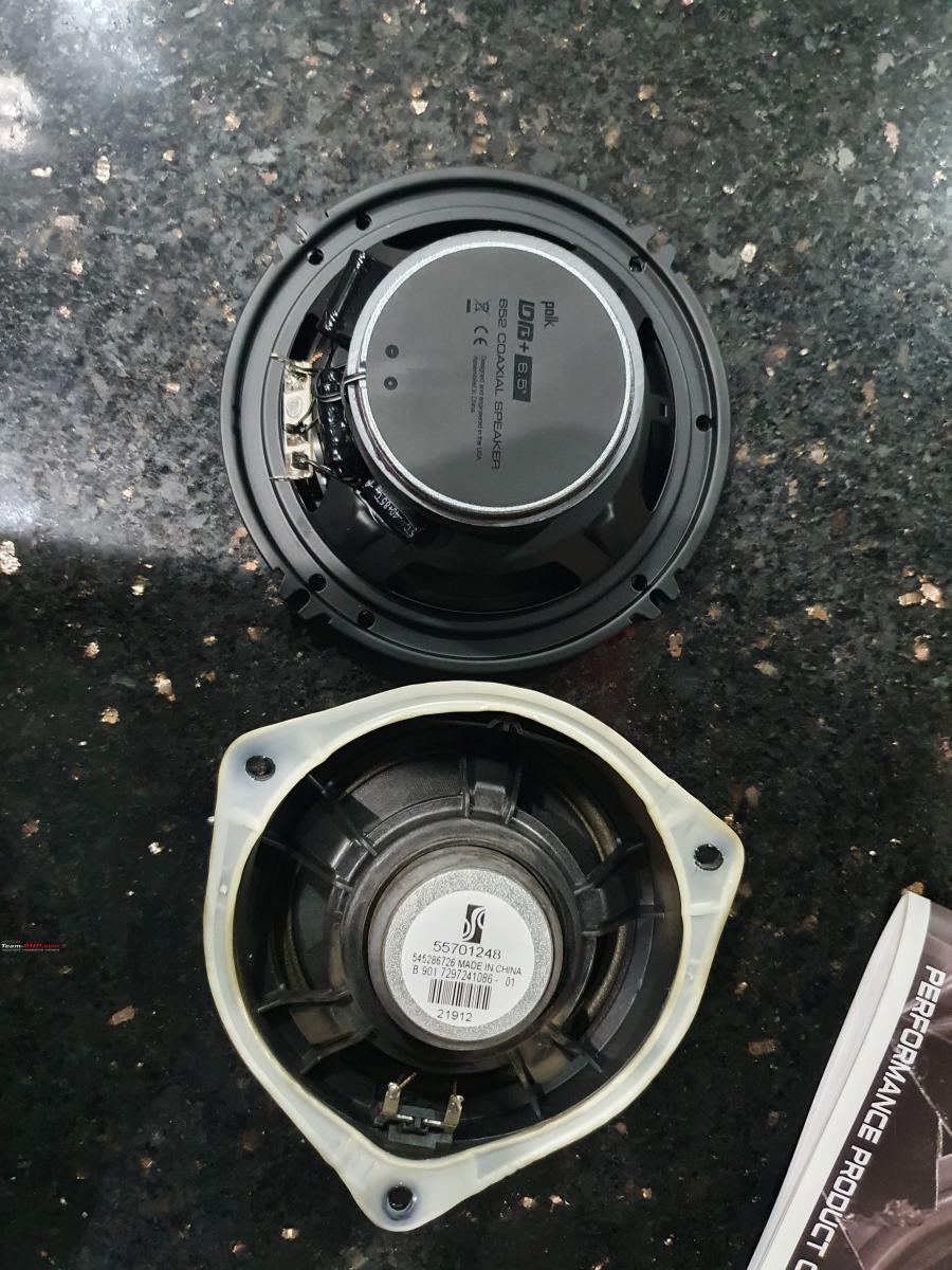

Rear Stock Speaker vs Polk Coaxials:

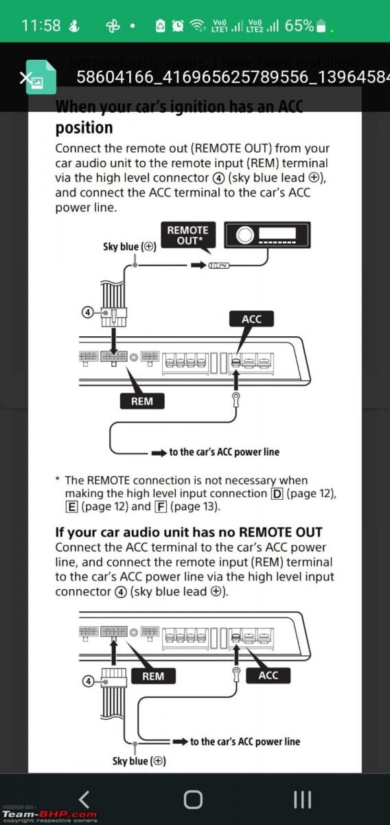

This is where we ran into a problem. The amp would cut off once we dial the volume up. No matter what settings we used the amp would cut off intermittently. This was turning out to be a big, big problem. Connecting the Phone via BT to the amp directly had no such issues. Later got to know that such a problem is standard with Linea HU and a fellow fiat owner told me that he listens to only BT audio and the HU is not used. This was a bummer as the audio output from the HU (CD or Ipod) was far far superior to the BT output.
The next option was to use a hi-lo convertor and then plug in to the signal input of the amp. Here there was no audio at all. We were following the manual yet there was no audio. We tried multiple convertors that my installer had and there was no audio. Nothing. Double bummer.
We called it a day and went home at around 11PM. Next day started to google around this and finally found one obscure link in which they had spoken about the solution:
It so happens that when giving a signal level input we also need to add a second remote line in from the high-level input for the amp to start working. This is mentioned in another part of the manual. Once this was done the amp started doing its thing and how!
