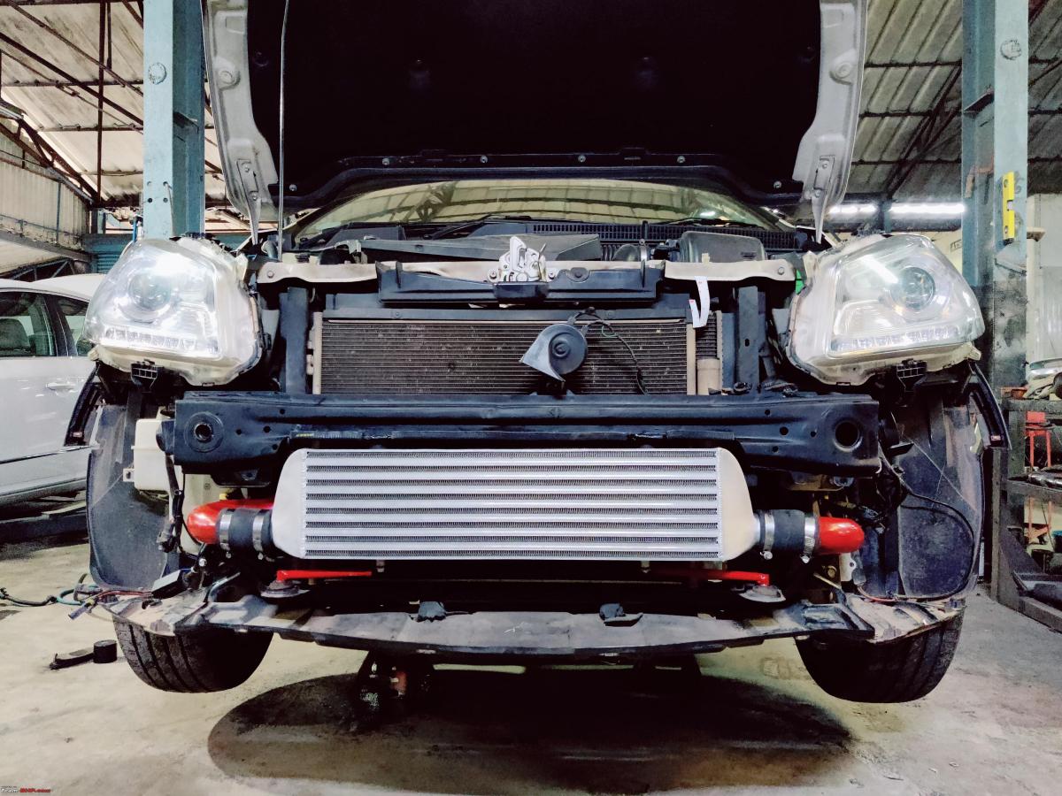

Few more pics
Installed
They made custom mounts for the new IC. Stainless steel plumbing was done post end tanks, I think they could have done a better job, not really happy with the 270-degree bends. The front member was slightly trimmed to accommodate the new intercooler. I was OK with this as the member isn't really strong to protect passengers in any crash and it is meant to protect only the radiator from minor hits.
The turbo outlet hose was compressed / pinched like this. I wasn't really OK with it. But, they assured me it would work fine and requested me to test it. They also didn't use silicone hoses at end tanks. I wasn't really confident about the installation, expected it to give up anytime.
