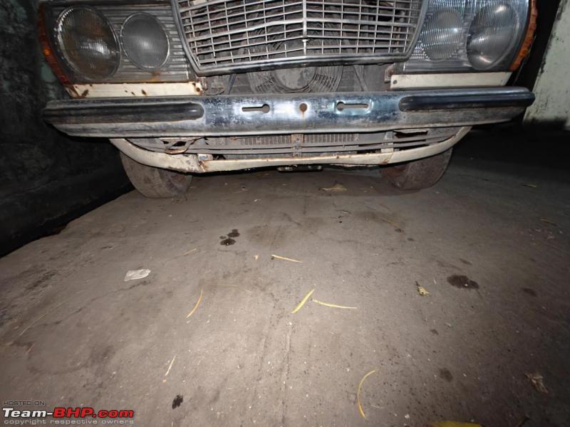

Interestingly, this W123 has had quite a story even before I entered the picture. Jatin sourced the car back in November 2024 — it was sitting in Madras (Chennai) in less-than-ideal condition and had it transported to Bombay to save it.
It caught his eye for one big reason: it’s a rare early 230E with the M102 engine.
At first glance, the car appeared to be a beige white shade. But while unloading, a few fallen-off trim pieces revealed a hint of China Blue underneath.
That small detail led to some digging, and after locating the original paperwork and also via the cars Datacard, it was confirmed:
This car was factory-delivered in China Blue! With the sunroof, autobox, manufactured in 1979.

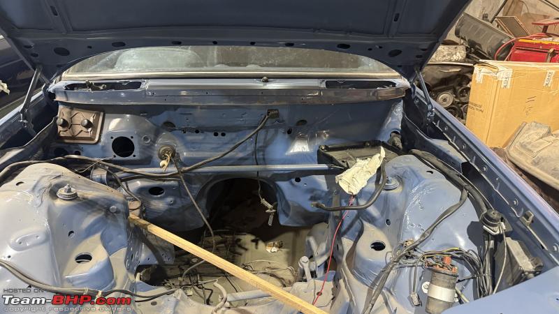

Since then, Jatin’s team has been working meticulously through the bodywork, sorting all the rust out properly — no shortcuts. The shell is now solid, and we’re finally moving toward the next big phases.
Current Stage:
  • []We’ve decided to rebuild the engine and gearbox along with the entire suspension system.
    []Some critical parts have been ordered (some still in transit).
  • The focus for the next month will be to get all mechanicals right first — before we touch the cosmetics.

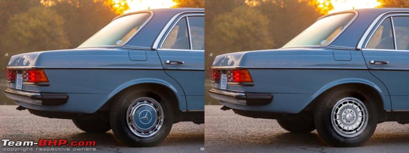

Originally, the car was sold with Bundt alloys (14 inchers). Now, 14-inch tyres are getting tougher to spec properly. There are replica 15-inch Bundts available, which is one option.
But… I’m smitten by the classic look of body-colour steel wheels with hubcaps.
I’ve managed to source a 15-inch steel wheel set, but the rims are 6J wide.
  • 175 width tyres would fit easily but might look too narrow for the car.
  • I feel 195 width tyres can still work well on 6J wheels without spoiling the stance or period-correct look.
Or should I go back to replica Bundts and call it a day?
