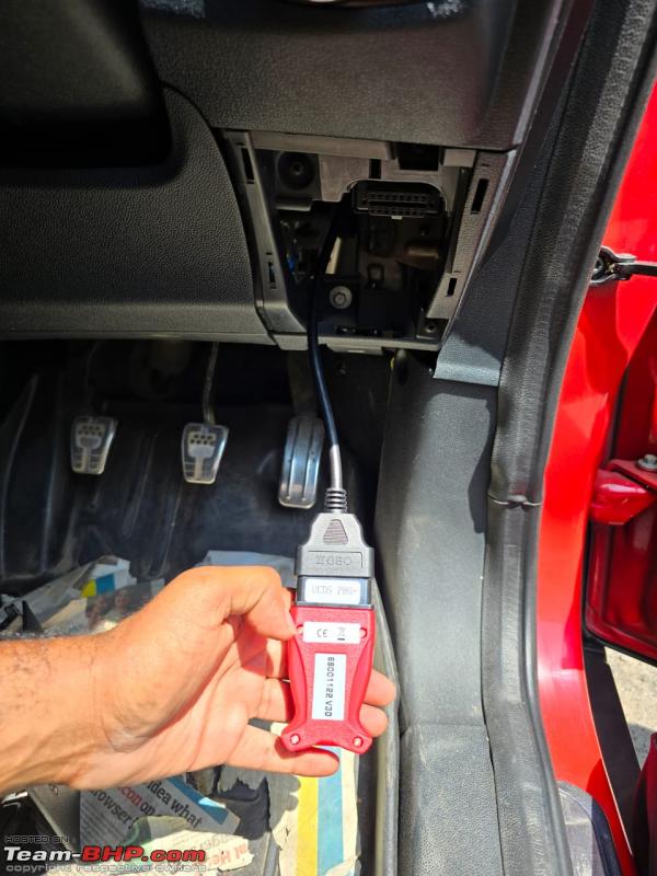

Finally I got my most awaited mod from Germany which was partly done by Fmods team. I got the OBD tool which displays critical engine data such as coolant and engine oil temp(for AT, even the transmission temperature can be displayed) as well as TPMS on the Sync 3 screen(very useful for Endeavour 2016-19, Aspire with sync3 and Freestyle with sync 3 as these cars do not display TPMS values directly. Aspire/Freestyle do not have TPMS from the factory but the TPMS frequency is same as the EcoSport which is 433Mhz and for the Endeavour it is 315 Mhz). This also displays Dpf and soot values which are useful for owners with Bs6 diesels. They have encrypted the OBD based on the VIN so that people do not clone their product and resell it. I paid about 160 Euros including shipping it to India.
I believe it is a super useful mod yet functional. Works with Android Auto/Carplay as well as an overlay. To make the mod working, first prep up the sync 3 by jailbreaking it and adding custom apps section. Then you need to procure the OBD from any of the admins in the Fmods team in Europe and then they will provide some files based on your vehicle and fuel type and you can flash that in your sync 3 and the OBD will get activated. Additionally for some CGEA cars we can change drive modes from the sync 3 screen(unfortunately EcoSport doesn't support it).

The OBD from Germany(I've connected it to the back of the OBD and sealed it inside for a discreet look, plus the main obd can be used as well)

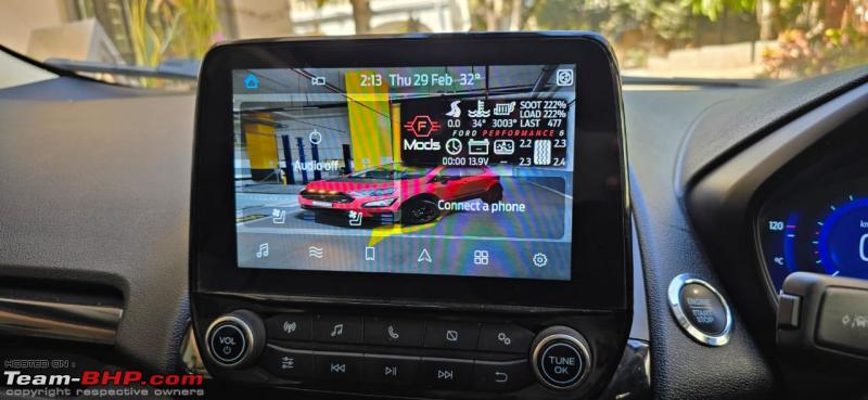

Home screen with info on the tpms(it's in bar)

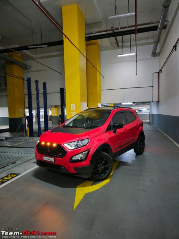

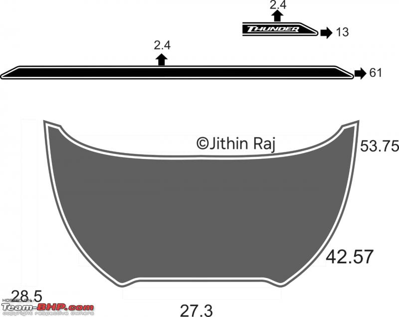

The next mod was to change the Car's theme to the EcoSport Thunder Variant externally. The Thunder Variant was launched in 2019-20 in four colours only(White, Silver, Grey and Canyon Ridge). No Thunder edition was ever present in red, so I decided why not. From Start to Finish, it was an exciting challenge as the stickers were insanely expensive at Ford for the bonnet(12k for the bonnet sticker).So I asked a group member to bring his car for reference at a sticker shop at Hebbal. Took measurements of the decal and asked my sticker shop guy to replicate the same. We have created a template as well with the exact measurements for future reference. We did something similar for the Storm stickers too and it came out well. One of our friends was very particular about using Avery Dennison sticker material as it is meant for automotives and recommended by OEMs such as Toyota and Ford. To identify an Avery Dennison sticker, their company logo and Avery Dennison will be printed at multiple places on the back side of the sticker material. The entire stick design cost was about 5k.
Thunder Template

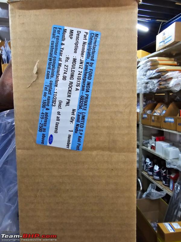

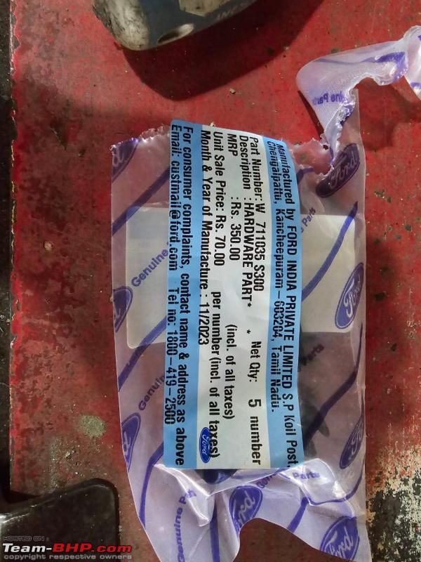

The stickers alone aren't enough for the Thunder variant, Ford being Ford as always did some tricks here too. They changed the entire running board for Thunder variant and the plastic cladding on the door as well. For the Thunder variant, EcoSport will be written on the rear door plastic panel. This took almost a month to arrive and the total expenditure for the door claddings and running board was about 11k(rear doors 800 each, front doors 1700, running board 3k each for left anf right and the fender plastic was 600 each).
I've attached the part numbers randomly
End Result for the side
The Decal and the Running board has been changed to the Thunder ones
