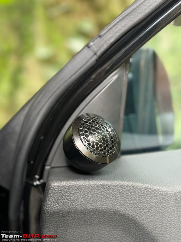

We decided to go for a proper simple Active 2 Way Setup with Ousail Handmade SQ speakers. Rohan put the previous equipment from the older cars for sale and we were all good to go.
Equipment:
  • Morel Handmade 2 way speakers
  • Helix DSP Mini
  • Helix M Six
  • Helix B10E (Retained)
I will llet the installation and the wiring speak for itself.
Angle Mounted Tweeters.
