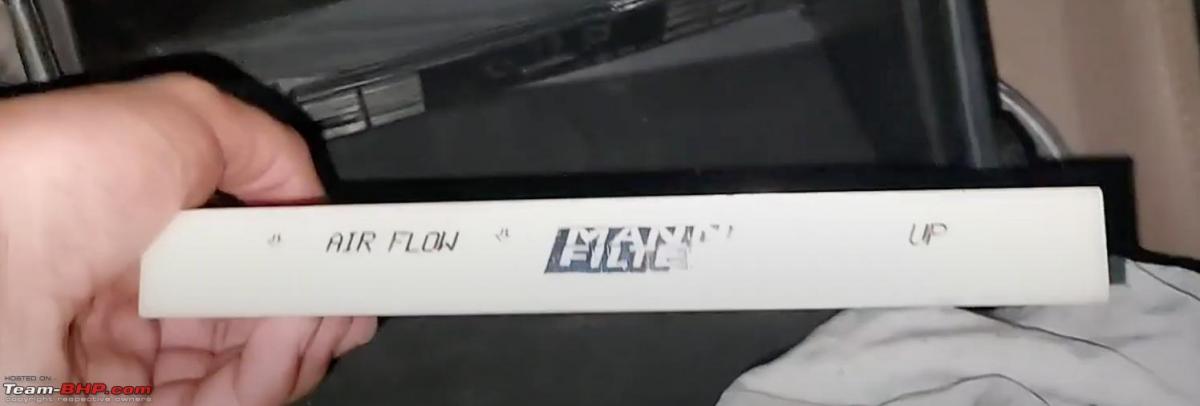

  • Now, you just need to take out the filter and clean or replace it according to your wish. (Note: To put the filter back in the correct direction is very important. The filter has airflow direction mentioned on it to help you in this. Or you can just use the "UP" symbol on the filter).
