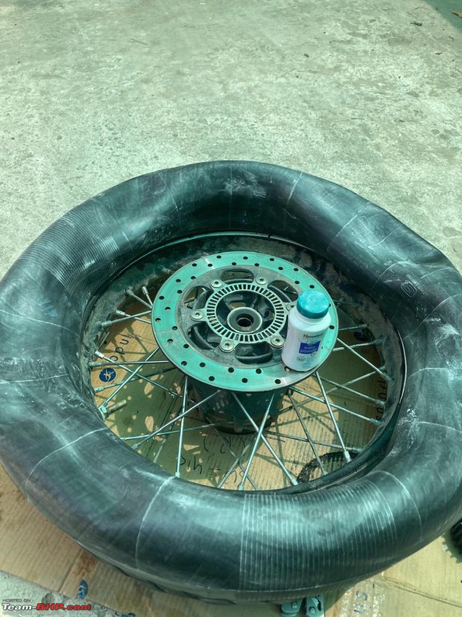

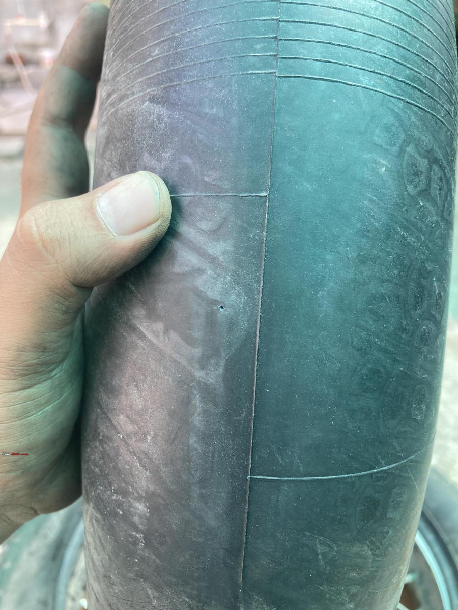

Take out the tube. First visually inspect for puncture, and also check around the nozzle. Retighten the valve and fill up air. Check for puncture(s), and mark them. Deflate the tube, use sand paper to rub around the puncture to make the surface a little coarse, easier for glue to work. Apply a generous coat of glue, let it dry for a minute, and then put the puncture patch over the hole. Use the lever/spanner to put a little pressure over the patch by gently pressing over it. Keep it aside for few minutes.
Now check the tyre for nail or any sharp object. It’s time to put the tube back in tyre. You can recheck the tube again by inflating it. Better safe than sorry. Insert the nozzle first and use the locking nut to keep it from sliding inside. Insert the tube in the tyre carefully. One trick I have seen somewhere is to sprinkle some baby powder over the tube. It helps with prevention of folds on the tube while inserting.
