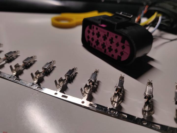

The headlights themselves have a T14 headlight connector, and so a few T14 headlight connectors were purchased along with the crimps to make a T14 to T10 harness. The part number is 1J0 973 737.
