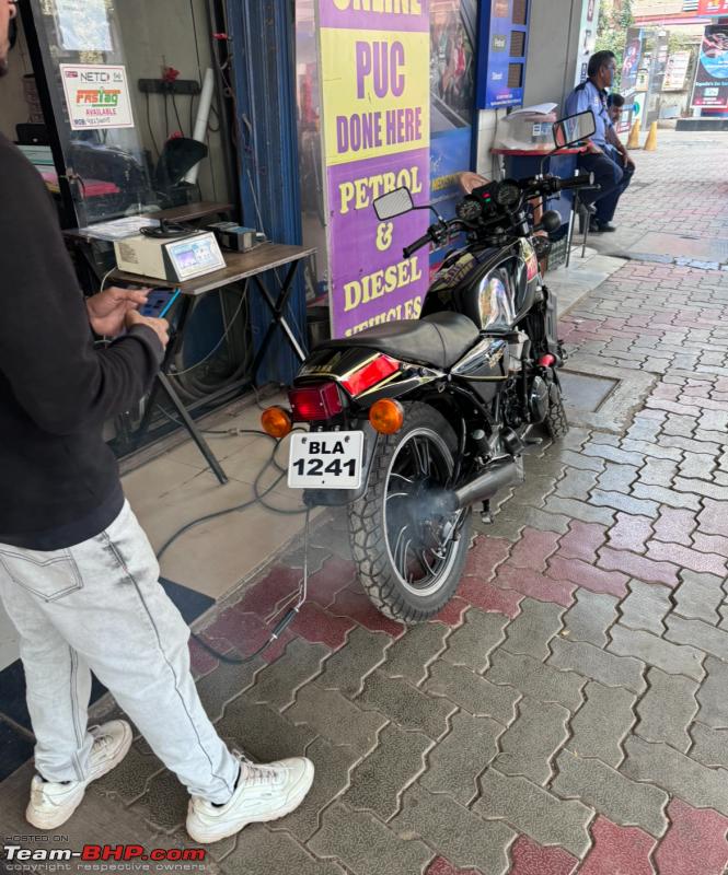

As, I had mentioned in my earlier post the bike was started on the 8th and over two days it went through 5 heat cycles in total and plus one complete rev out while idling to set the engine up before we put it in gear and ride it under load. The first start was just for a minute and the remaining four lasted for 10 mins each followed by a 30 minute cool down period and the last cycle was done with an overnight cool down period. Today, I had to ride the bike to provide initial feedback especially on the fuelling to see if the carb setting is on the lean side. So, after an initial shakedown ride in the vicinity I went straight to the fuel pump to fuel up followed by getting the PUC done. The bike was filled with under 5 litre of fuel and I was running it in reserve and at the fuel pump another 14 litres of fuel went in. People were just staring at the bike as this is one Yamaha to identify and especially with an old Bombay number but looks like which has just stepped out of the showroom. Even the PUC guy is like have you just restored it and I was like yes and this is my first ride on it. On, my first ride I noticed that the gear shifting was on the harder side and the throttle would stay open even when I cut it off. So, with this feedback, we opened the accelerator cable completely and even took out the needles. One of the carburettors needle looked slightly bent so that was straightened out and some settings were done on the accelerator cable. Further the slide springs were changed to a more harder one for a quicker return of the slide when the throttle is shut. On the needles the mixture was made slightly rich which would help for smoother gear shifts under load. So, as the miles pile on we will understand the bike better and keeping making small changes until we are satisfied and achieve the final desired setup.

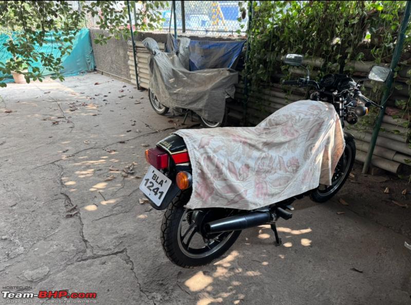

Time to take the dust cloth off

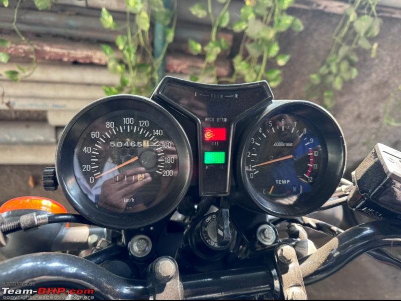

Km reading before the first ride

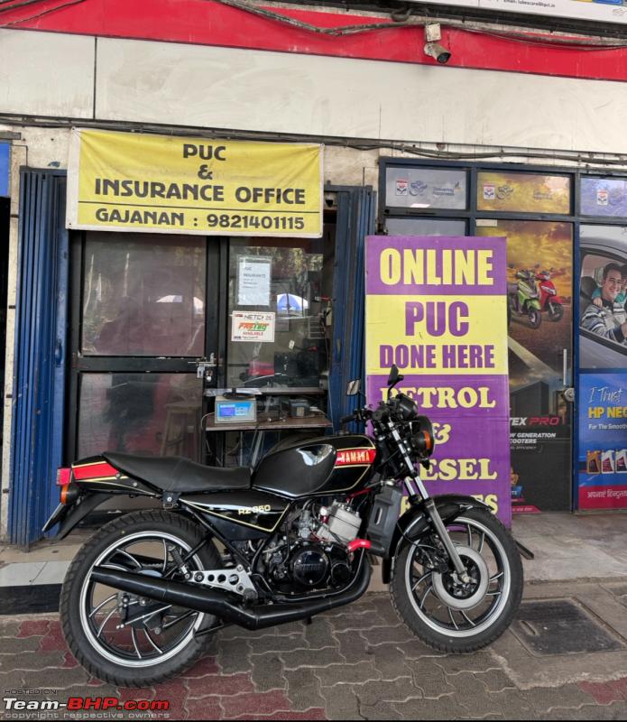

Post fuel fill up time for the PUC
Looks complete with the engine and exhaust on
The PUC guy was impressed as well looking at the bike. Two strokes are now getting rarer on Mumbai streets and then you see a rare two stroke among a sea of four strokes

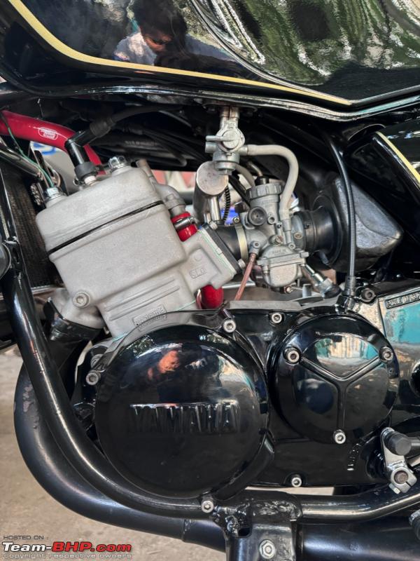

Engine up close

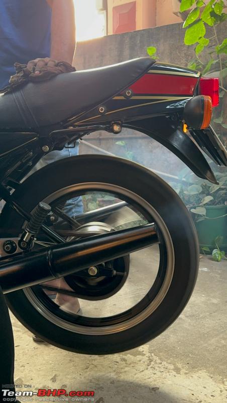

The rear is missing the rear grab rail and chain guard. Don’t miss my RX in the background which is getting its headlight holder worked on

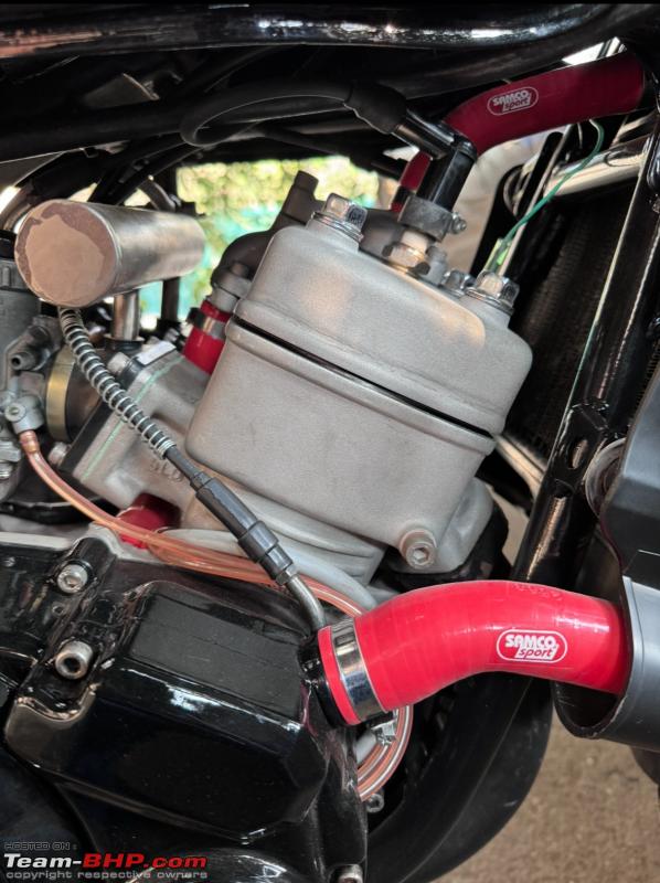

The new radiator cap
The three red SAMCO hoses will now be on the bike for life
The green wire is for the temperature sensor/gauge

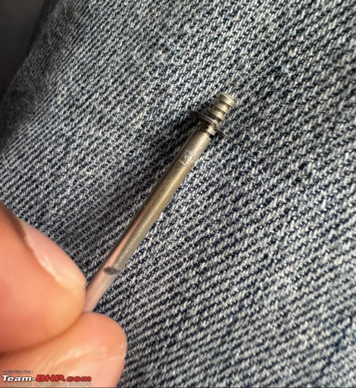

Time to address the carb settings
Needle setting being done

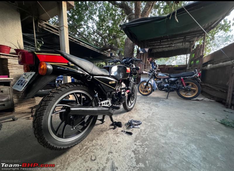

My first two stroke also my first bike and my latest two stroke in one frame

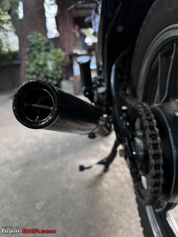

Exhaust have a unique design
The way they curve outwards
