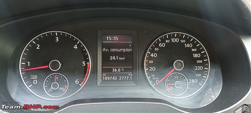

Zero complains on the fuel efficiency front too. The lowest I have seen after spirited driving on highways is 17 km/L...
And the highest was a staggering 24 km/L on it's last drive with me from Vadodara to Mumbai. Mind you, this is a stage 1 2.0 TDI putting out 180hp and 400nm:
