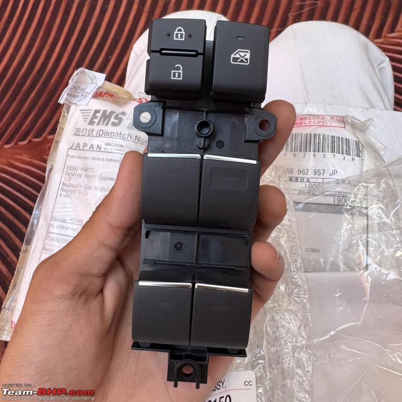

The Part 84040-42150 shipped by YoshiParts from Toyota Japan
The Master Window Switches Panel in flesh
The 2 Couplers I mentioned earlier, the smaller one for the Mirror Adjustment & Auto Fold/Unfold and the larger 20 Pin one for the Power Window Switches, Lock/Unlock and Window Lock Button

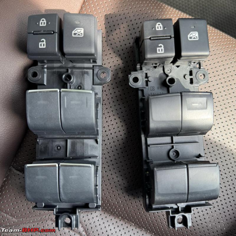

On the Left; Part No: 84040-42150 which has all buttons illuminated in White with Chrome Tips, meanwhile On the Right; the Stock part with only the Driver Window Switches illuminated in White

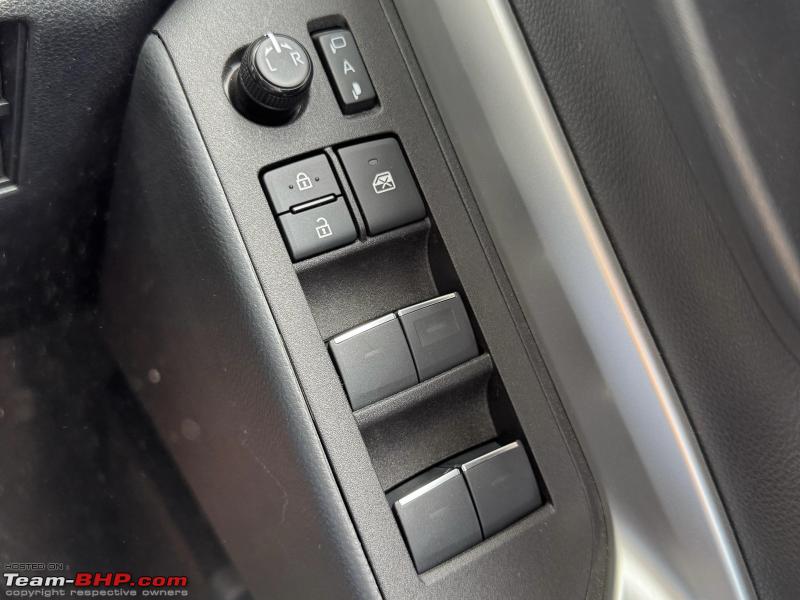

Part No.: 84040-42150 Installed side-by-side with the cheap stock one
The Stock Master Window Switches Panel that comes with the HyCross from Factory; Part No: 84040-VT010
