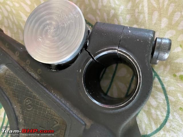

When Arjun was about to put the forks back in, he was trying to look closely at which leg was on which side and he was horror-struck to see a crack in the fork leg on the piece that holds the axle in place. There are pinch bolts to tighten that piece and it seems somebody had over-torqued these and the part had cracked. This was a big blow as we had planned an overnight trip the following weekend. I left the bike at Arjun's place for him to do his magic and came home a bit disheartened.
We had 3 main options:
  1. To repair this in some way.
  2. Get a new/used fork - Very expensive and the bike would have been out of action for long depending upon when I could spare this much money and sourcing of part.
  3. Get the fork leg changed - could be an error-prone solution as taking the fork out of fork legs needs heat treatment and there is a chance that replacement will not sit perfectly. Still quite expensive.
We did some research and found that this is not a load-bearing part and its primary job is to hold the axle in place. Arjun worked his magic and came out with a repair solution.
We got a metal piece fabricated and fixed it with nuts to provide support to the cracked piece. So far it has been working well.

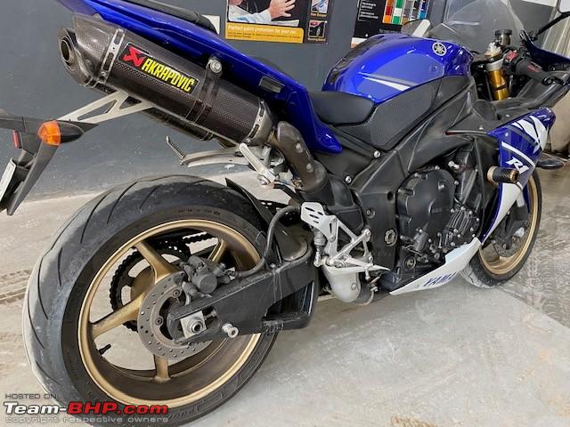

Arjun always wanted to take the baffles out of the exhaust to hear the full cross-plane thunder. I was a bit sceptical because I did not want a very loud bike. However, we did remove the baffles just to try and boy did it make a big difference on how the bike felt after that. It seems that the bike breathes better now. The low-end throttle has become smoother and the low RPM complaining of the bike has also improved. I am planning to keep it this way only. Thankfully the exhaust is only about 10-15% louder and not obnoxiously loud.
