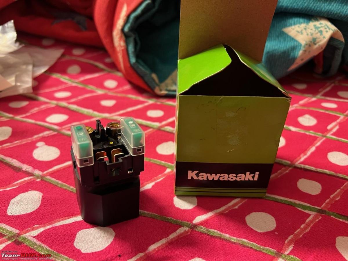

Next step in the order of expenses was to replace the battery and I ended up buying a normal Exide battery in replacement to the Yuasa battery at 2k rupees and while the first crank was quick and I assumed the problem was solved, it reappeared in a few days. This issue was making me leave the engine running in all signals and temporary stops. Finally did some google and figured out there is a starter relay that goes kaput in the bike. Since I would hear the clicking noise every time, I always thought that the relay was working fine and there was some other problem. Now this was supposed to be close to 11k in the ASC. Talk about the stupid costs of these parts.
Ordered this along with a few other rubber parts and fasteners from Megazip, which turned out to be an excellent place for OEM parts and came at a landing cost of 8k for the genuine relay. Note that there were some alternates available for 2k odd rupees in Amazon but I did not want to get an aftermarket replacement for such a part.

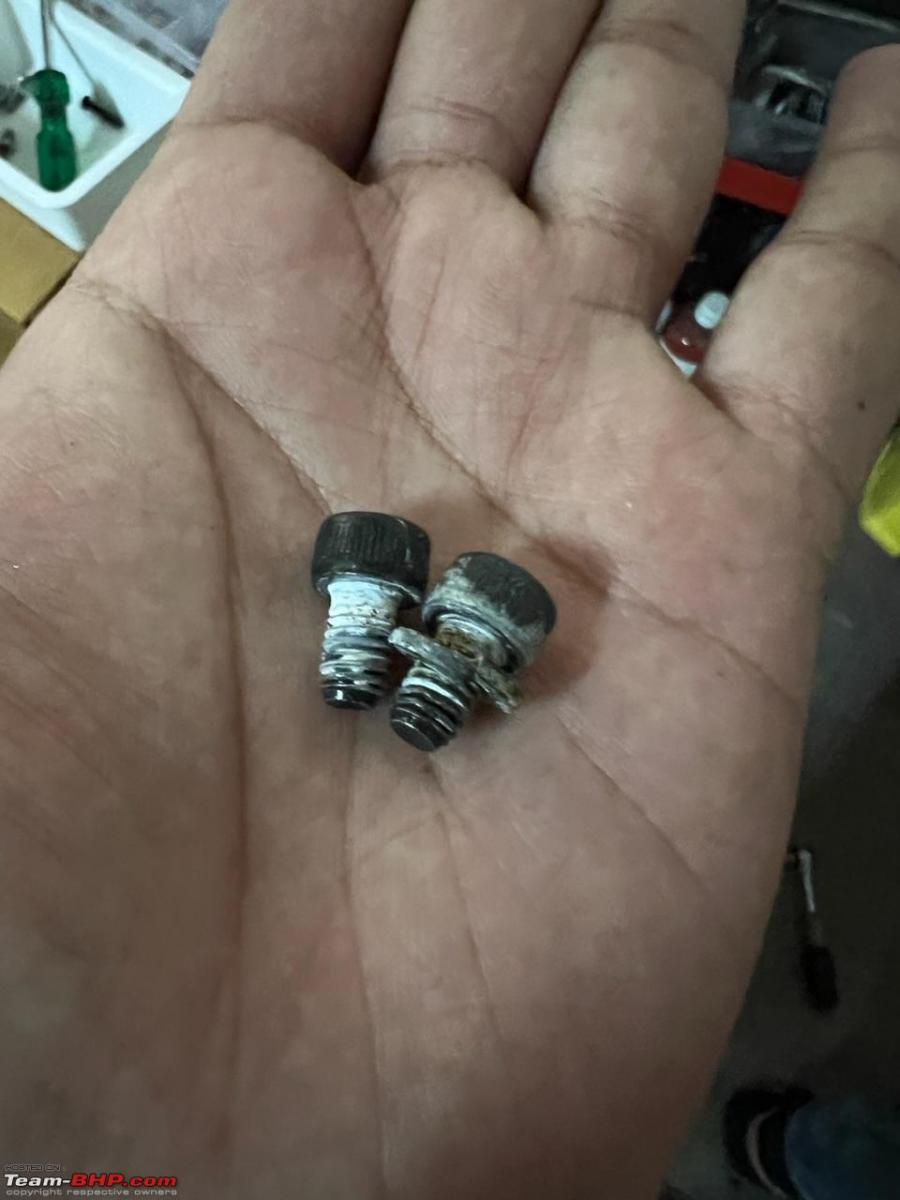

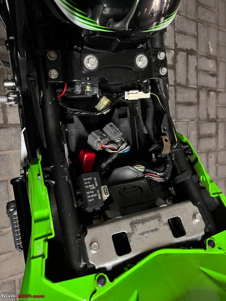

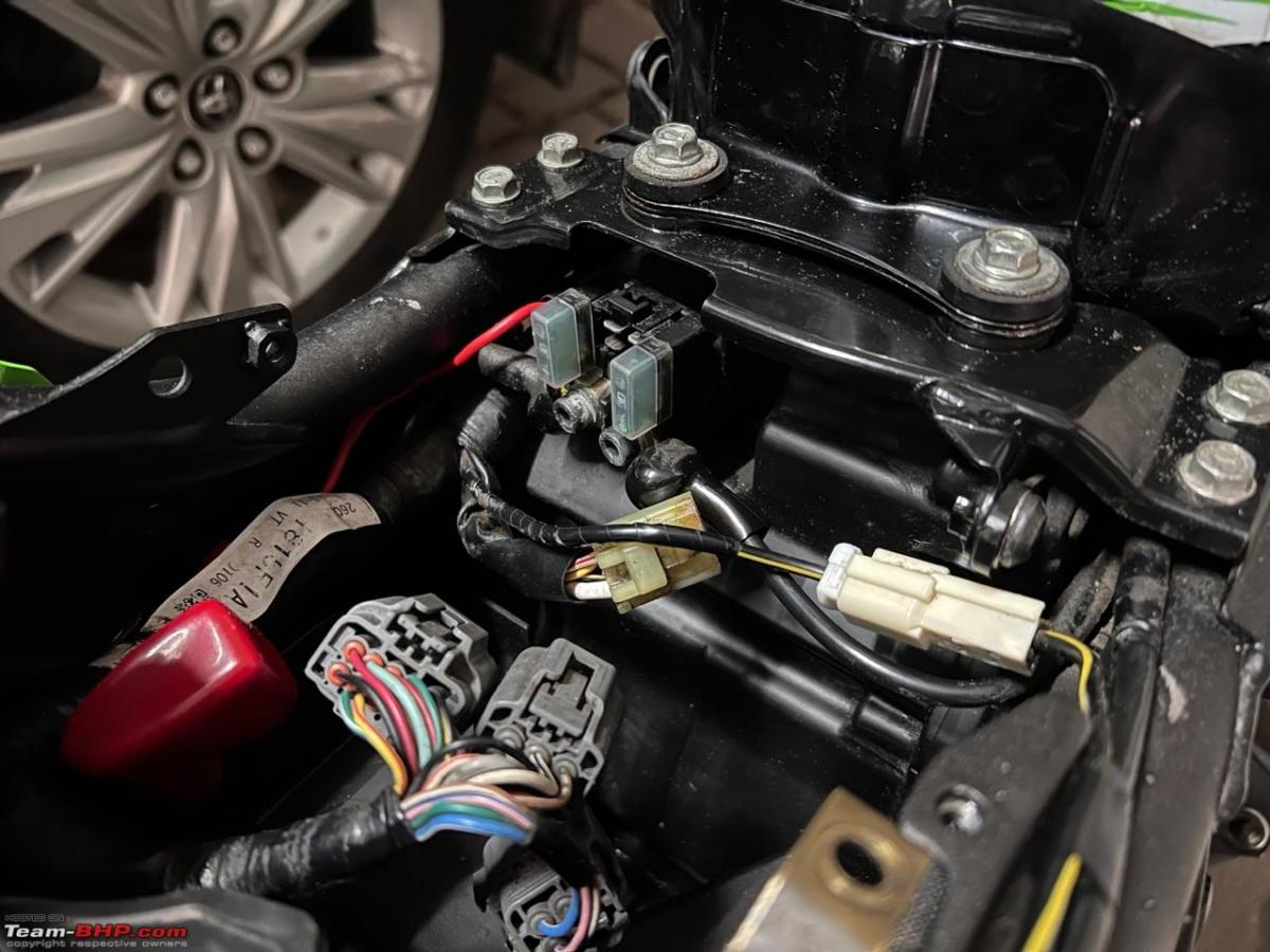

Replacement was fairly straight forward, even though it involves removal of the seat cowling, seat assembly, disconnecting the ignition controller, removing battery. Since I removed all these I ended up cleaning the whole place and then removed the old relay. Turns out that the old relay had corroded badly inside and its contacts and traces were in bad shape. Even the allen bolts were badly corroded. Cleaned up the whole mess and refitted the new relay with plenty of silicone grease and a generous coat of anti rust spray around the area.
