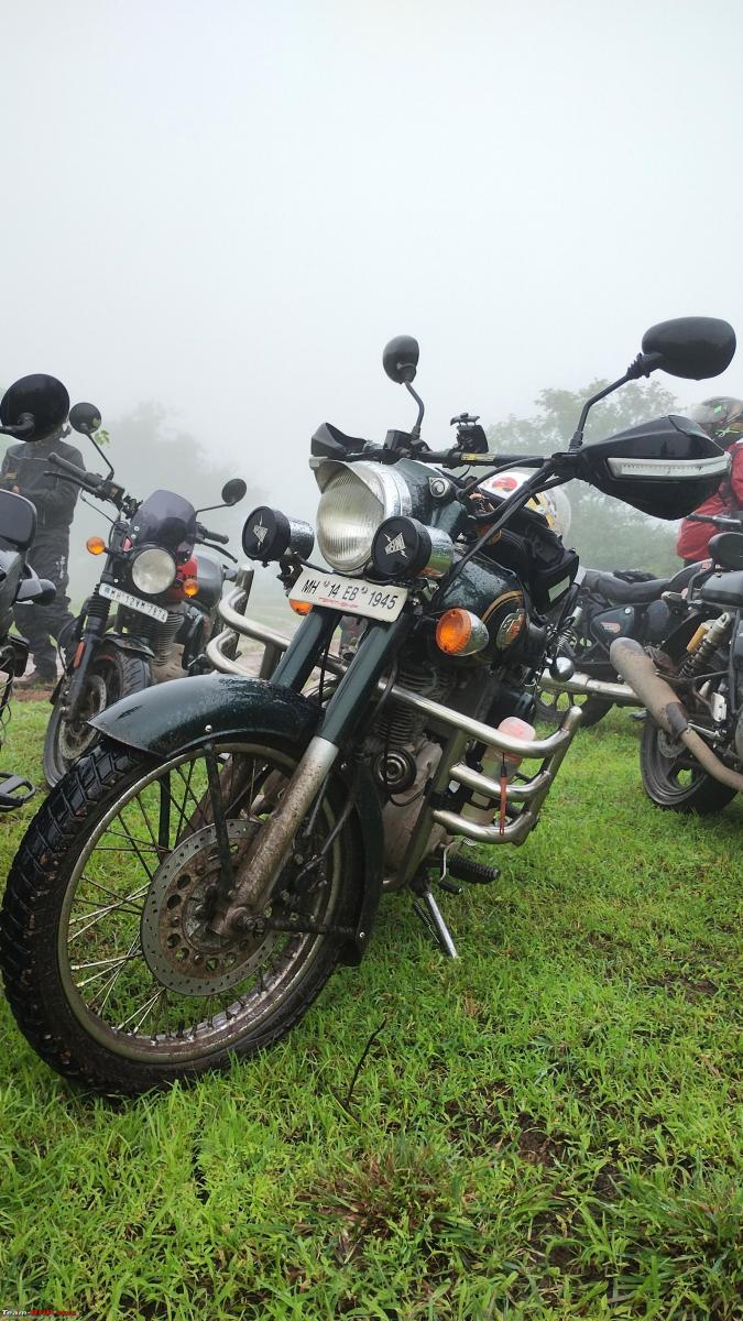

With no more unwanted sound and rides due for a pretty long time, I could no longer contain myself (though I was a little short of 500kms) and made a trip to the Solashi windmills (21st July) with the new 350, 450 and 650s. Mine was in fact the oldest bullet in the group. Time flies so fast, that 10 years just seemed the other day. From being the youngest Royal Enfield bullet in the group (2014) to the oldest one today. Anyways, riding with these new Royal Enfielders is another ball game all together, which I understand, everyone has to go through. Overall a very good experience over the slush, and thankfully could retain the balance both ways. A few pictures

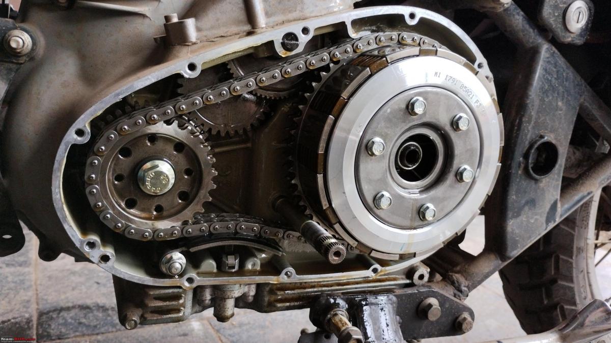

This morning I visited SC again and after one key press, technician deduced that whatever temporary fix he had tried with the ES earlier, has not worked and informed that the clutch gear set has to be replaced. Well, with hardly any other options and with an interest to know what the temporary fix he had applied, we went ahead.
Isn't this a sight to behold
Notice the spring kind of fixture, this is the fix which had been applied; as the one that is fixed within the assembly had broken off. Unfortunately the fix did not work and it has broken off too. That solves the mystery of those terrible sounds. Since the spring kind of fixture was not working well, the levers started to behave erratic and was causing the sounds. And once the spring broke off, the levers just became free and could not move the connecting lever end which moves the motor so as to start.
