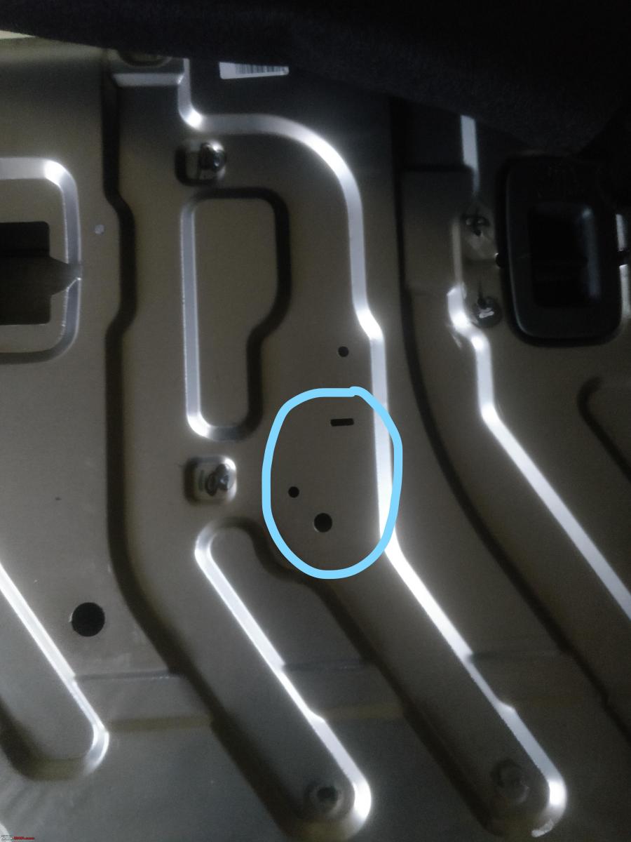

Fit the seat belt assembly: The leather seat cover cannot be removed from the foam side as it is pinned from the inside. However, the fabric on the side facing the boot is held using a rigid plastic sleeve. Additionally, a plastic clip holds this cover to the steel seat frame at the bottom centre (this clip is right in between one of the ISOFIX mounts). Pry it out using a screwdriver. Another plastic cover secures the fabric in place near the tether anchor. Remove this plastic cover (use tweezers to pull out the clips), and the seat cover moves away freely, exposing the steel sheet ‘welded’ to the seat frame! This welding was a significant setback as I thought I could remove this sheet entirely to fit the seat belt assembly. A word of caution: the edges of this steel sheet are pretty sharp – make sure you protect your hands while working. I covered the edges with microfiber towels. The foam on the right side (wheel side) separates without effort while the centre portion (with armrest assembly) does not move. There’s enough access through the wheel side to insert the seat belt assembly into the slot. There’s only one way the belt goes into the seatbelt slot. Once in place, use the secured bolt from step 2 and the locknut to tighten the seatbelt assembly.
Seatbelt slot highlighted
