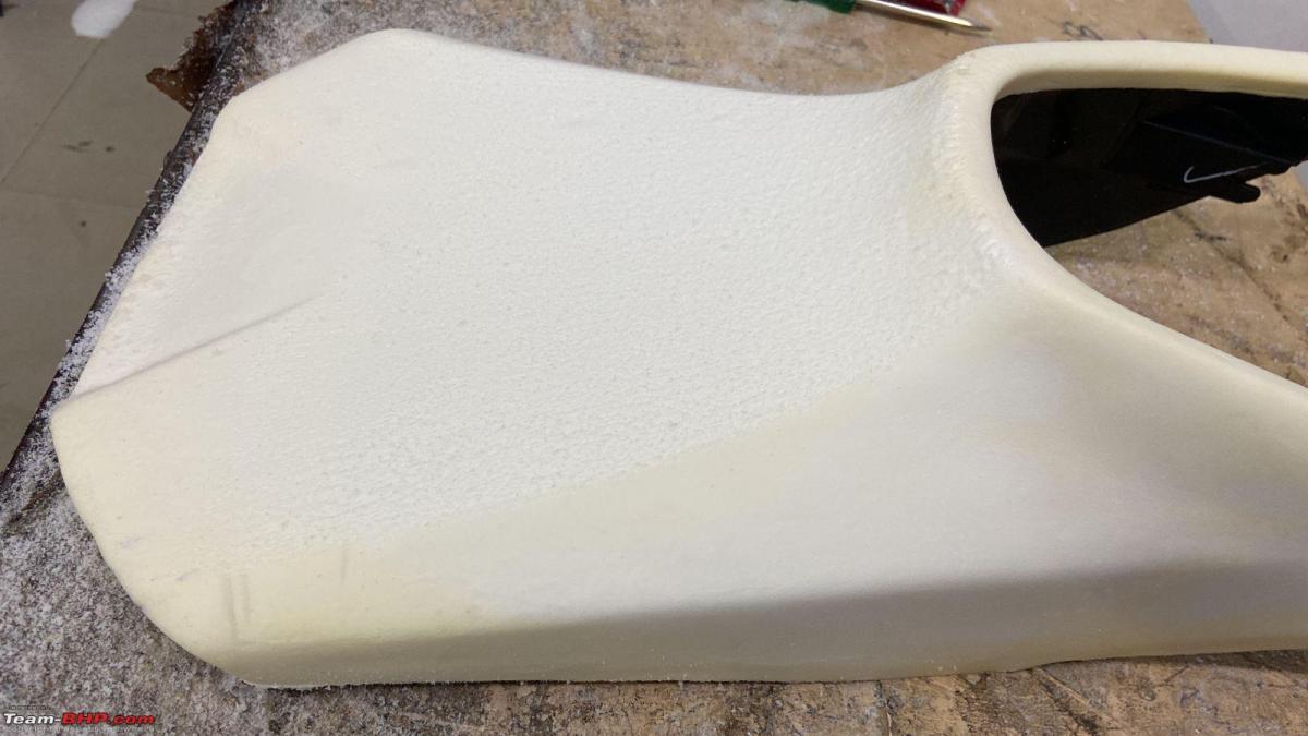

I thought this would be the end of my worries if I ate some cost. I said the budget was not a constraint, and the seat height increase should not be too much. They initially suggested that a rubber foam would be enough. They scrubbed the original seat slightly (nothing was cut as I recommended against it), and put a rubber foam and another soft foam on top of it.
Opinions on the gel pad were mixed, and fearing too much increase in seat height, I decided not to go with the gel pad.
They took 1500rs, which was lower than what they quoted initially, and overall their support was good.
This is the photo after scrubbing.
This is the photo after adding rubber foam.
