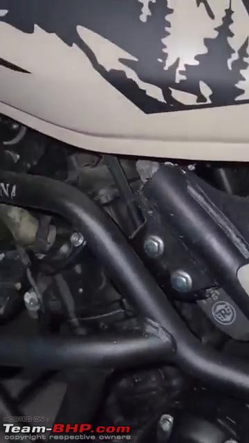

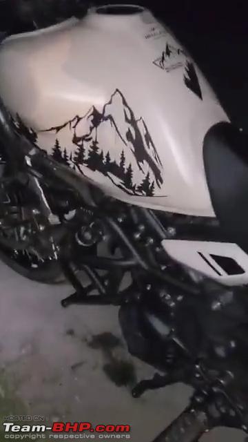

BHPian CLASSICREBORN recently shared screenshots of a video (now taken down) showing what could be the first report of the new Himalayan 450's chassis breaking. Below is what he mentioned:
Link to the first Himalayan 450 chassis breakdown I found on YouTube. I think it is from Tinsukia Assam.
Adding some screenshots since the video is no longer on YouTube.
Following this, BHPian VijayAnand1 also shared similar photos of a Black Himalayan 450 suffering similar failure. Here's what he mentioned:
Chassis Breakage #2!!
Not sure about the preceding events, but sharing it as received.

Amidst a lot of discussions, speculations and back & forth, one possible reason which stood out was the installation of aftermarket crash guards. Here's what BHPian neil.jericho shared:
In a thread full of unproven suppositions and speculation, here is 1 more unproven supposition and bit of speculation that might put some worried minds to rest. Like everyone else on this thread, I don't know the truth, one way or the other.
Royal Enfield's technical team had a word with Autocar India, here's an excerpt what they had to say:
"The bolts that connect the engine to frame are specialised, load-bearing units which are designed to be able to retain the correct torque specifications over a long term period. Moreover, the connection between the chassis and the engine also uses a specifically designed spacer that is integral towards retaining the torque setting and correctly spreading the load from the bolt.
In both instances, when the customer installed the aftermarket protective guard, different specs of bolts were used and this likely led to incorrect torque settings."
