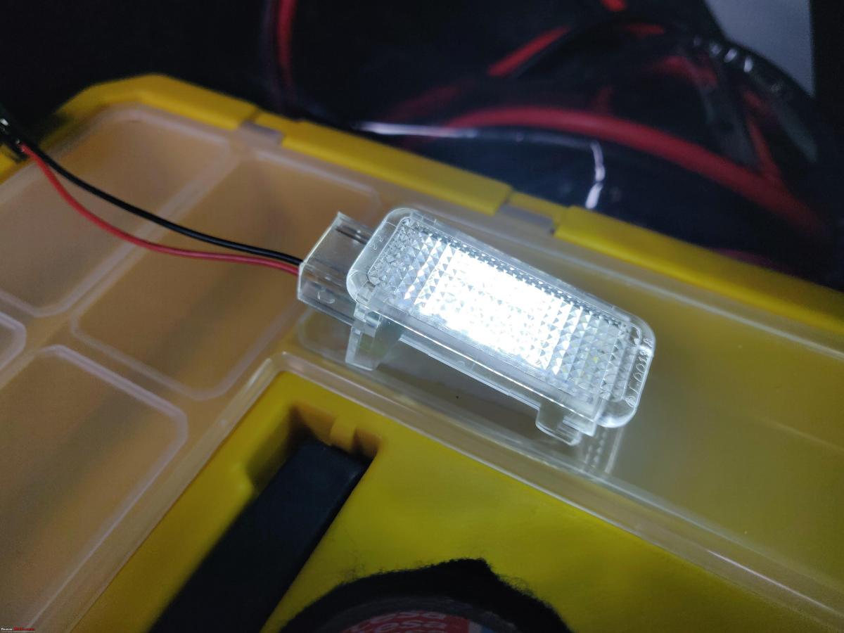

Long ago, I bench tested a bright LED assembly and finalised its wiring. Ignore the messy wires, since they belong to multiple retrofits which were in the testing stage:
The assembly was ingeniously installed to light up only when the trunk door was open, and was not triggered by the central door open signal:
