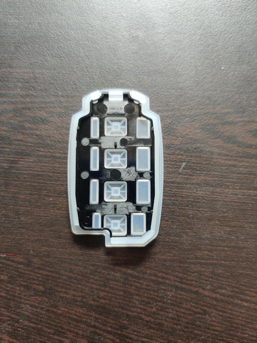

Take a flathead screwdriver and use it to open up the case by inserting it in the gap (as shown between the two red arrows). While doing this, I was careful not to press any button that might damage the electronics inside.
The inside of the key
I was again surprised, and somewhat relieved, as there was no trace of water inside it.
The circuit board is mounted on a plastic platform and very well covered by a silicon casing
Separated all the parts carefully. Everything felt dry and not a single drop of water anywhere.
