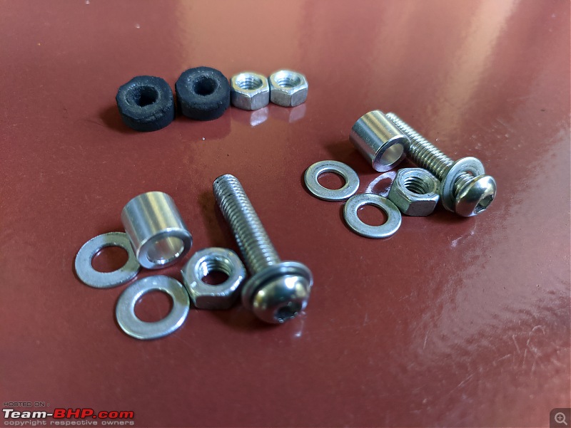

Initially tried to piece the mounting hardware together with the stuff that came with the screen but later changed to these. Two M6 30mm SS bolts and nuts with two M6 10mm aluminium spacers and a few washers. These mount the screen through the holes on the side of the number plate holder. Two rubber bushes that came with earlier windscreen installation to dampen the number plate vibrations.
How it fits. The spacers were necessary as the windscreen was wider than the number plate holder by about 20+mm. This however is a sturdy setup.
