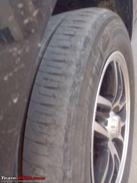

I have been facing an issue for sometime now.
A bit of history behind my case-
Car- indica Vista
Tyres- Upgraded from 175/65 to 185/65 Michelins
Issue Faced- None
6 months later changed the rims to Zeki alloys.
Problem faced- None
2 months later alignment done from a reputed shop in Gachibowli
Problem faced- Uneven wear on the outer edge of the left front tyre.
Diagnosis- was told to visit the dealer as the camber/ caster was off and this adjustment was only done by them.
Visited the TASS and they fiddled around and made some adjustments.
Issue- still persisted. They also informed me that the suspension had to be changed.
1 month later changed the suspension in the hope that the tyre wear would be arrested.
However I have noticed that the wear has reduced but is still there.
Any idea what could be wrong guys?
The first snap is the tyre which is on the front right now. This was exchanged with the rear right tyre. This is the damage to the tyre now.
The second snap is of the tyre which was on the front earlier before the suspension was changed.
To let you know the steering is absolutely straight with no pull at all.
Something that I face, however,is a weird feeling when turning right.
