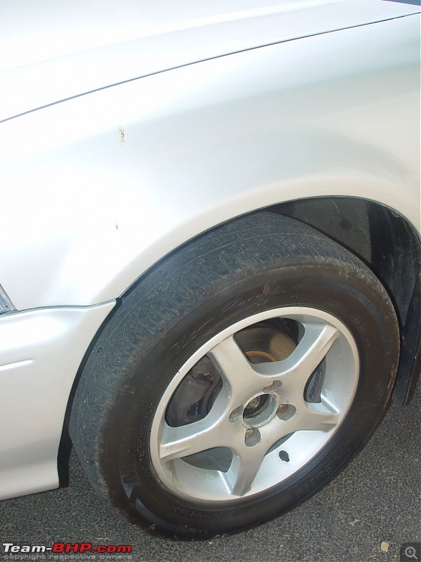

Hi Everybody
The front tyres on my OHC wore out much faster than the rear tyres (pics pasted below). I have Michelin Pilot Preceda 195/60/R14 in my car and they have done between 10k-15k (not too sure but definitely within this range). The uneven wear & tear (i guess) started around 4 months back.
Issue (1) "What caused this uneven wear and tear (premature balding) and how do i prevent it in future?"
My mechanic felt that the front wheel bearings could be causing the problem. Subsequently, I had the entire suspension and brakes overhauled (overdue anyway) and now the tyres need to be replaced as well.
Issue (2) "Which tyre is best suited for my requirement"
My car is a 1997 type 1 OHC done about 80k. The current Michelin PP's are the 3rd set of tyres running on the car. The first set was Bridgestone, second set was Falken (the car is a hand-me-down and bro doesn't remember any details about the tyres). Budget per tyre is 5 grand. Priorities in order are reliability, performance/handling, comfort and life. I checked out Michelin Pilot Preceda and XM1+. I guess PP is suited towards handling and XM1+ is suited towards comfort. What other tyre brands/models would you recommend?
Note- The (worn out) tyres which were originally in the front are now in the rear and vice versa. The pics were taken after the rotation.
Please advise.
Thanks
Vijay

When was the last time you rotated the tires? How many kms since then and how much has these set run.
Your uneven wear has to do with alignment and air pressure more than anything else, hows your driving style? Lil on aggressive side ?
Guilty as charged.... I drive a bit on the aggressive side!
Don't remember when the tyres were rotated last. However, i felt that the tyres started wearing out on an exponential basis and before I could even realize it, they were bald. Oh and BTW, forgot to mention, the car is predominantly driven on a light load and I maintain tyre pressure of 28psi.

The increased front wear will always be there since it's a Front Wheel Drive car and most of the wear and tear is concentrated on the front tyres. That is also why timely rotation (5k kms interval) is absolutely necessary to maintain even wear between all 4 tyres.

Thanks Iraghava! I have been complacent about rotating the tyres. Lesson learned.
Also guys... any suggestions wrt my tyre buying decision? I would like to get the tyres changed as soon as possible and get the alignment done (to complement the suspension overhaul).
