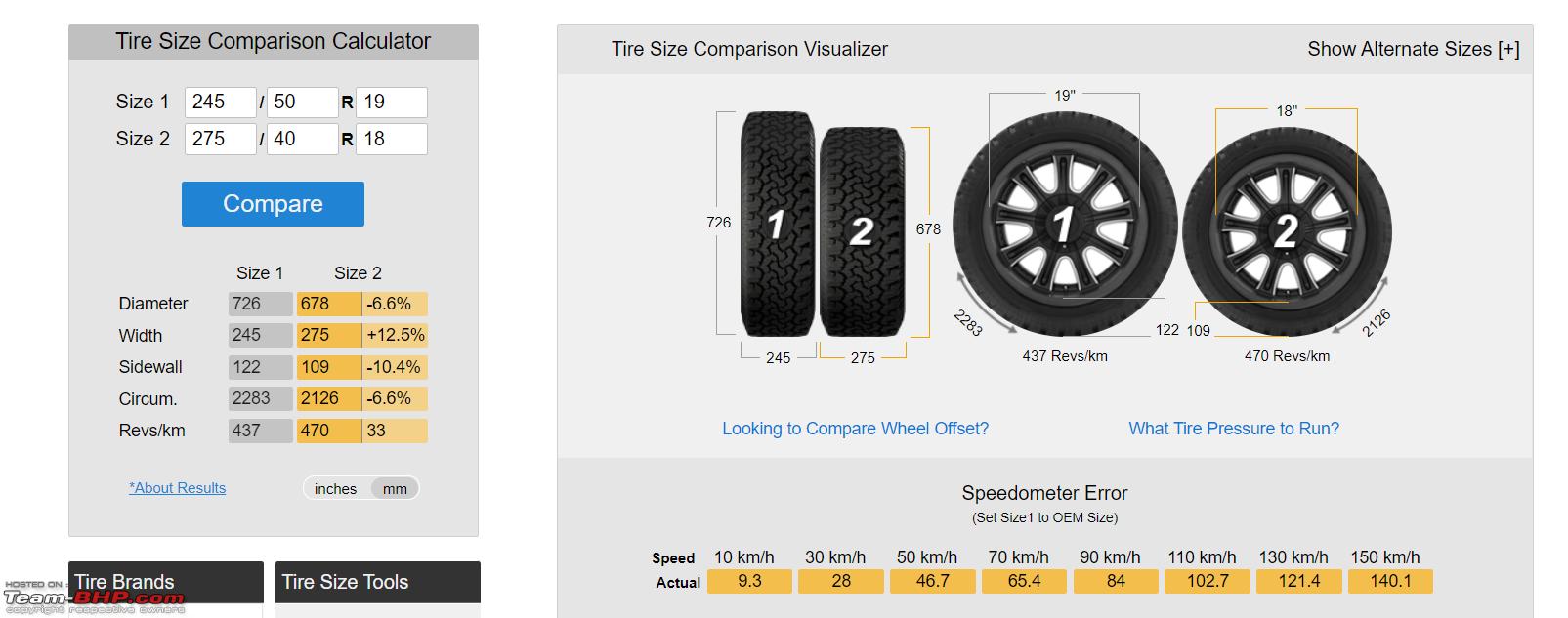

Originally Posted by Axe77 View Post
If I'm not mistaken the current X3 also comes with 19 inchers. Surely that's going to be a disaster right, if even 18s are not holding up? Any thoughts on this one? Haven't heard too many gripes from X3 owners so just wondering why that's not caused as much issues.
Even I was a bit worried about 19 inchers in the X3 but compared to the 530d's rear wheels, X3's 245/50/R19 (122mm) has a good 13mm higher sidewall than the 275/40/R18s (109mm). X3 SportX variant's 225/60/R18 (135mm) has an even more healthy 13mm over the Luxury Line's 19s (at the time of replacing my tires will surely look at GLC's 235/55/R19 tires if available). More than anything it's the lack of options that's affecting the 530d's rear wheels, as said 650Nm eats through anything less than 275s.
Completely fed up of damaging my 18" rims | Bought an extra full set of wheels-tyre-comparison-.png
Recent visit to the shop as the rear-left rim was bent and caused a slow puncture:
Attachment 2231025
Could 275/45/R18 be an option (Porsche Panamera uses these)? Side wall looks really healthy compared to stock 275/40/R18s
Completely fed up of damaging my 18" rims | Bought an extra full set of wheels-tyrecomparison-2.png
