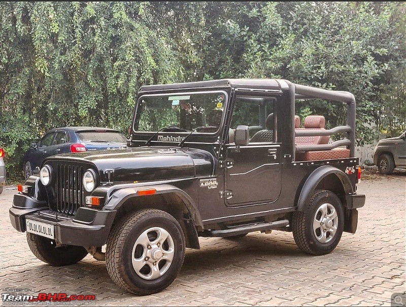

Hey, I had been in this confusion for several years. It seems like there's no one who can do the 2020 Thar-like roof conversion. However, I did get very close to it.
The primary requirement was that the top should be easy to take off and quick to put on. It shouldn't be so difficult that I don't feel like taking it out without the top, nor should the passengers get drenched if it rains suddenly.
This setup takes about 2 minutes to take off, 5 minutes to put back on. And if there's two people, it takes only about 2 minutes to put it back on. I don't think it could be easier than this.
The canvas top slides into the slit at the top of the windshield, from there you pull it backwards. Then you push the sides and back and fasten them onto the turn buttons which have been fixed on the body. Zip up the sides, and it's done.
Some pictures:
Review: 1st-gen Mahindra Thar (2011 - 2019)-screenshot_20200908192150.jpeg
Review: 1st-gen Mahindra Thar (2011 - 2019)-thar1.jpeg
Review: 1st-gen Mahindra Thar (2011 - 2019)-img_20201003_172055.jpeg
Review: 1st-gen Mahindra Thar (2011 - 2019)-1.jpeg
Here's one with the roof back on:
Review: 1st-gen Mahindra Thar (2011 - 2019)-whatsapp-image-20210817-12.56.10-am.jpeg
This job was done at Bimbra 4x4 (Gurgaon). Quite happy with the final job, especially considering that everyone else refused to even try anything similar. I do feel the quality of execution could have been better. The turn buttons they have used seem flimsy too. And some minor niggles that I guess any modification/any workshop mechanic would serve to you.
Got this done a year ago. No complaints, enjoying it so far. [sidenote: the soft top got torn due to a protruding tree branch, have to get that fixed. But that's not really a fault of the mod, just a soft-top con.]
This job involved changing the roll cage at the back, removing the cross-shaped bars on the front, and attaching the turn buttons.
There's a pretty neat video showing how the top is removed. Would share here if someone can guide me as to how I can remove/blur my number plates in the video.
Would be happy to hear feedback/comments on this.
Exactly my requirement. But I like the OEM fitting, its fits tight without any uneveness anywhere and without a noise even in high speed.
Isnt the convertible a choice by many. How come there are no vendors for it, even after close to 10 years of the model in market?
