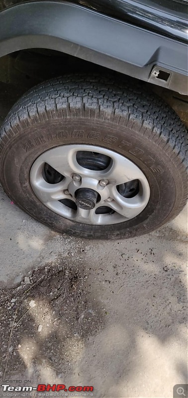

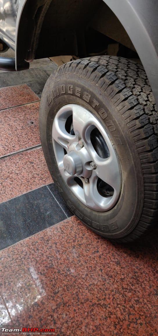

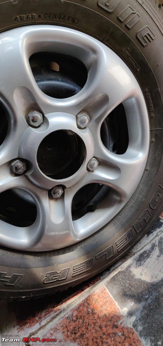

Hello, need some advice.
Someone stole a wheelcap and some part that was inside the wheel cap from two of the wheels from my Thar. I'm not sure what this other part is. I'd be grateful if someone could let me know what it's called, what it's supposed to do and whether the vehicle could suffer any mechanical damage from the lack of this thing.
Wheelcap:
Review: 1st-gen Mahindra Thar (2011 - 2019)-whatsapp-image-20200911-12.27.12-pm-1.jpeg
Wheelcap stolen; the black-part which I need to identify, remains on the front wheel:
Review: 1st-gen Mahindra Thar (2011 - 2019)-whatsapp-image-20200911-12.27.12-pm.jpeg
Black part stolen from the third wheel:
Review: 1st-gen Mahindra Thar (2011 - 2019)-whatsapp-image-20200911-12.27.12-pm-2.jpeg
Apologies for the noob question, but any help and guidance would be much appreciated!

Originally Posted by N.A.GTC View Post
Hello, need some advice.................................
......................but any help and guidance would be much appreciated!
Nothing to worry. The front "Black" part is the Auto Locking hub. It is present in both the front wheels.
The rear wheels don't have the Auto Locking hubs. So you need not worry about it.
navpreet318 is offline   (2) Thanks
