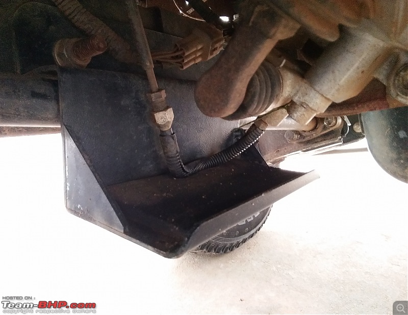

Originally Posted by sharc_biker View Post
This engineering flaw in the Thar caused me to lose the clutch midway when crossing a stream and hit some rocks underneath. It was partly my fault as I was forced to go slightly off the designated path to avoid another vehicle. The transmission skid-plate took most of the impact.
I was luckily able to slot the car in reverse and could power out of the stream. We tried to patch up the broken metal pipe with insulation tape in vain.
But, it stopped further leakage of the clutch fluid and we finally had to be towed by another jeep until a mechanic arrived with the replacement pipe and the vehicle was fixed up in no time.
The very first accessory I got for my Thar CRDe was a direct bolt on clutch pipe protection from Swastik Fabs (http://www.swastikfabs.in). After every OTR I can see scratches under the protection plate. The clutch pipe on the Thar is very vulnerable and I wonder why the engineers at M&M didn't think of protecting it.
