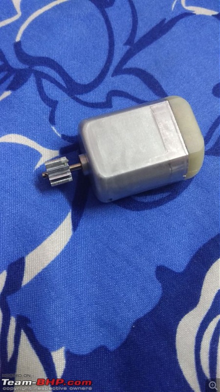

I am having trouble with the boot lock actuator (see attached image) on my Figo. The actuator is not moving enough to open the boot when I try to unlock boot using remote or pressing the unlock button on the dashboard. A.S.S suspect that actuator is bad and need replacement costing 3K excluding labour. I found a video on Youtube which is the exact problem I am facing.
If I am not wrong, these lock actuators used to be pretty cheap. Suggestions are welcome.

Update – I was able to strip the actuator and found that the 12v DC motor was the culprit. I cracked open the DC motor to clean the carbon deposit on the armature. Voila!! The motor started working fine and so is the actuator. Now, I just need to seal the actuator using super bond and install it back.
I feel bad about the exorbitant prices at which F.A.S.S sell these things, it's just a Chinese 12v DC motor which merely costs 100 bucks . To be on the safer side I will look for another DC motor and change the old one if it stops working again.
