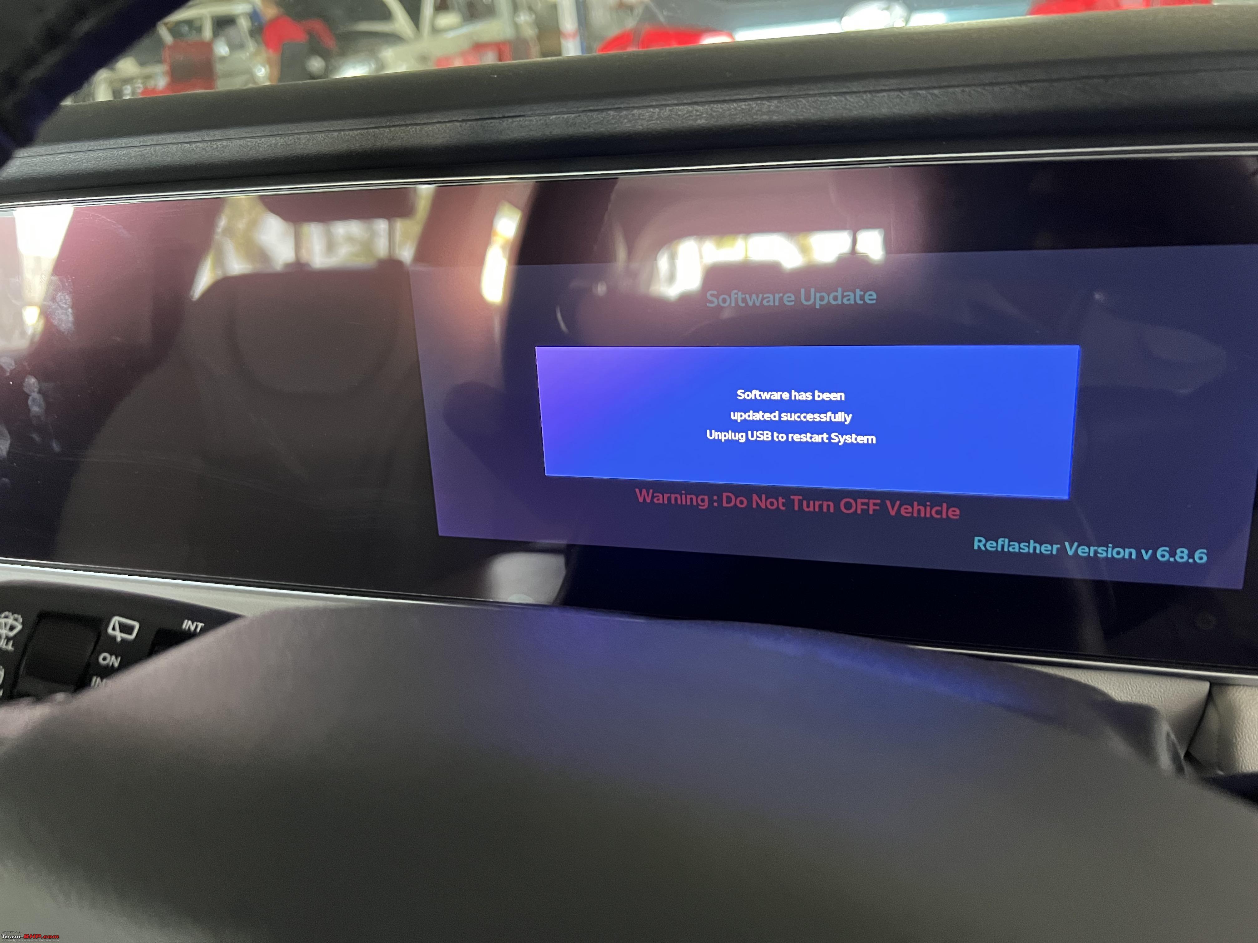

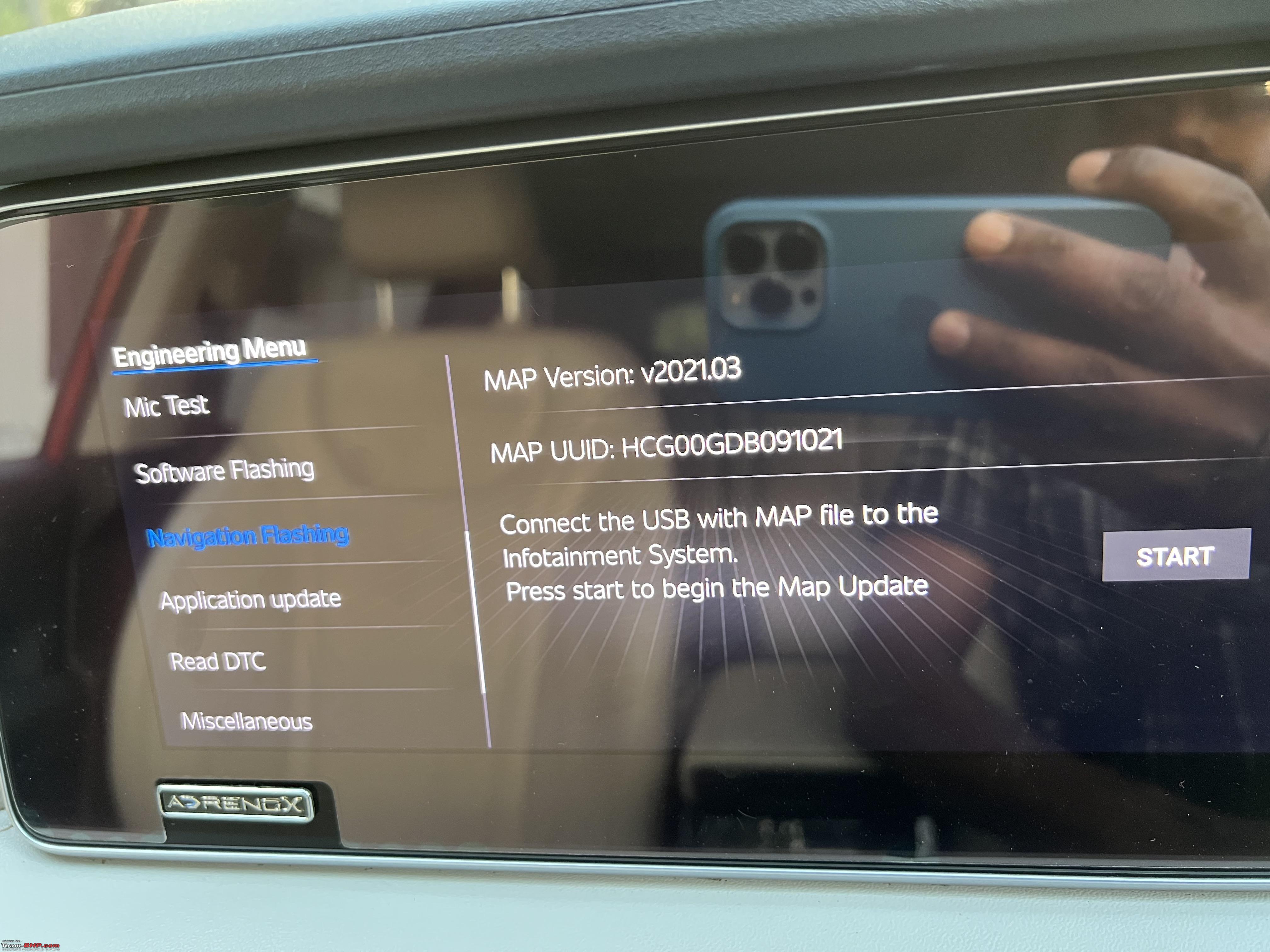

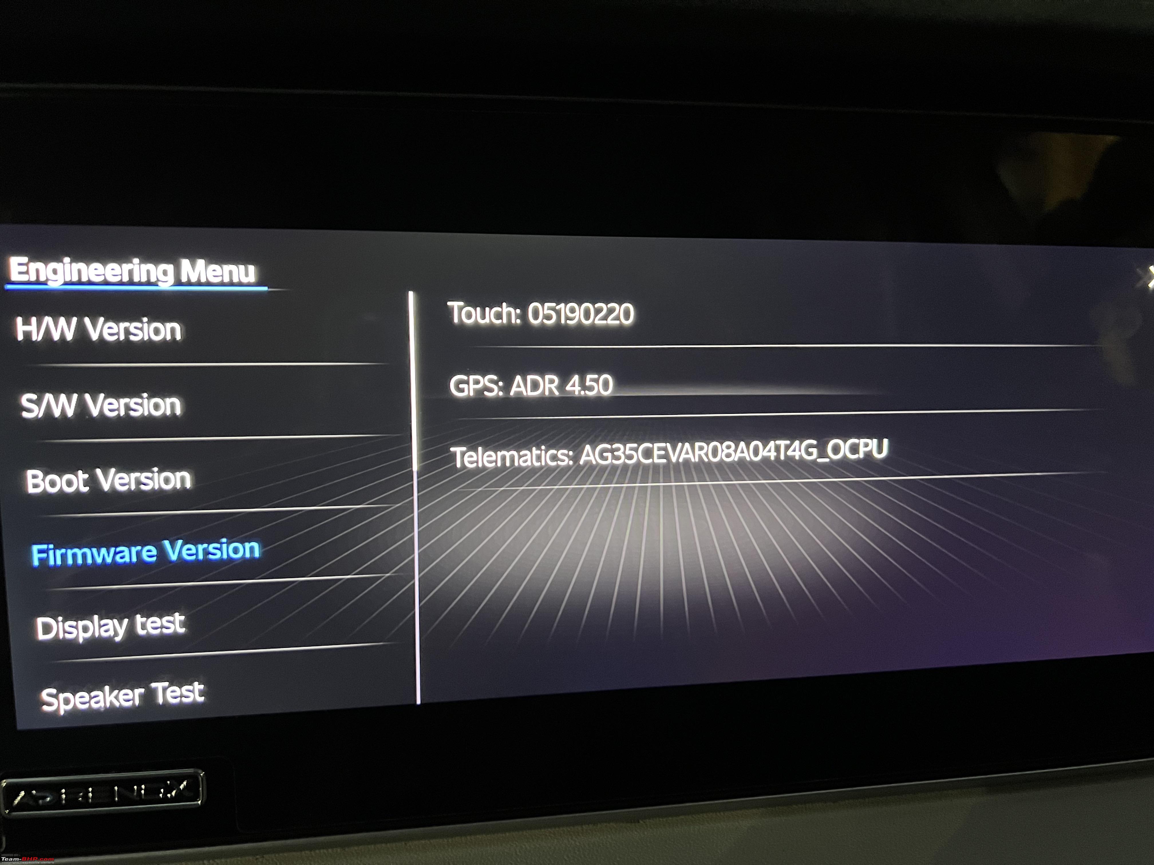

In the meantime, the co-tech (apparently short for Technical Coordinator) comes in with a USB, mentioning that Android Auto is ready. And so guys, almost 5 months after deliveries started, Android Auto is available. Read on! You might head over to your ASC for those with Android devices if you were actively looking forward to this. But don't rush as yet.
iPhone users have to continue the wait.
