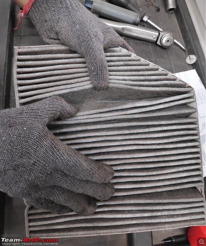

3.2 Dust filter - clearly dirty, but I have seen worse. No point in retaining it.
My Mercedes-Benz GLC 220d Progressive - Ownership Review-dirty-dust-filter.jpg
3.3 Fine particle filter - same as above.
My Mercedes-Benz GLC 220d Progressive - Ownership Review-dirty-fine-particle-filter.jpg

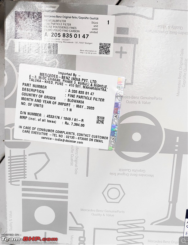

New part numbers
Dust filter
My Mercedes-Benz GLC 220d Progressive - Ownership Review-fine-particle-filter.jpg

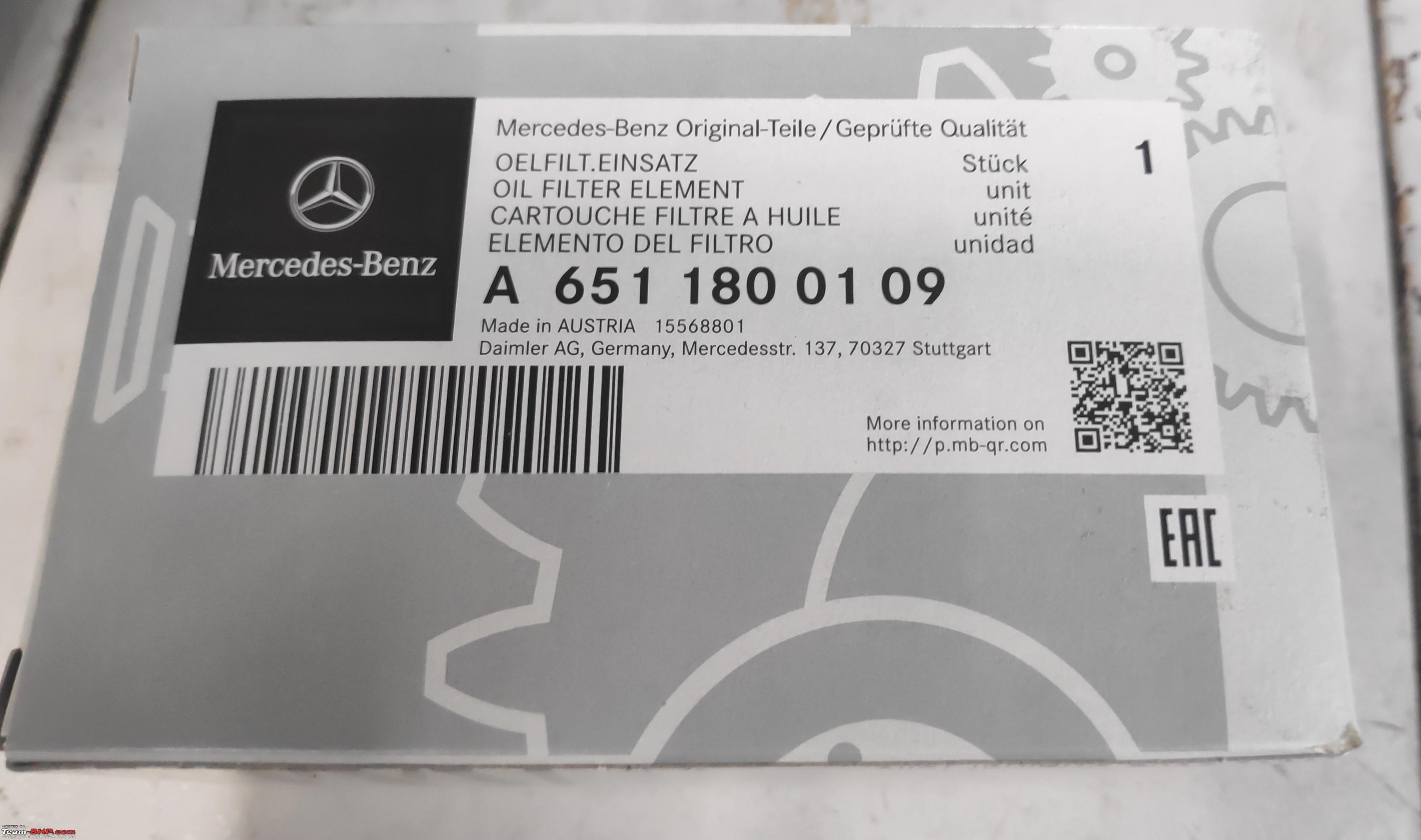

Oil filter part:
My Mercedes-Benz GLC 220d Progressive - Ownership Review-oil-filter-element-box.jpg

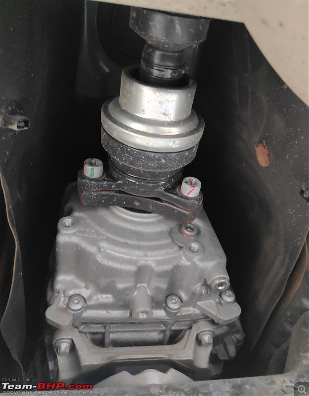

Front differential - looks clean.
My Mercedes-Benz GLC 220d Progressive - Ownership Review-front-differential.jpg

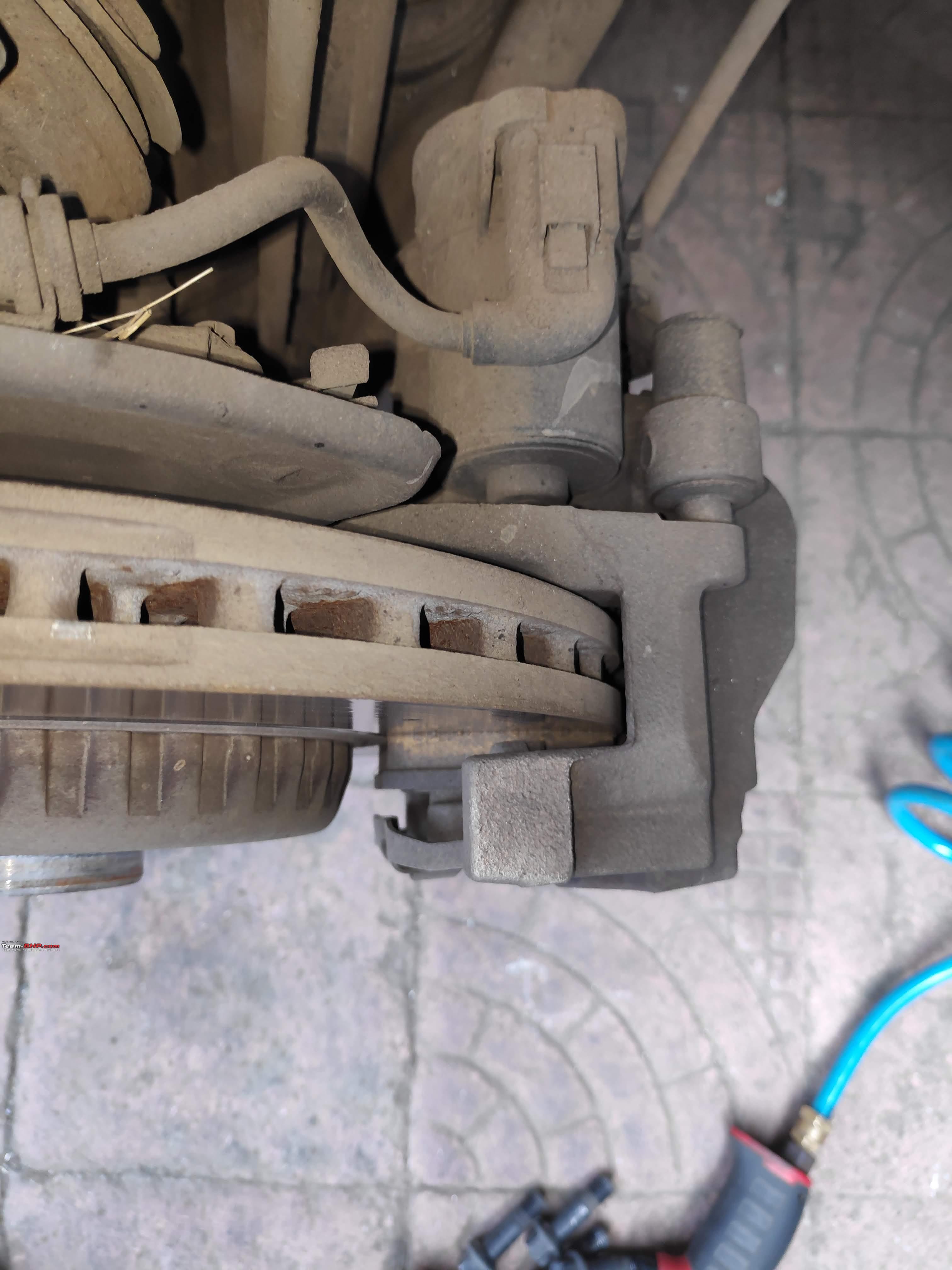

Front brake caliper - looks good.
My Mercedes-Benz GLC 220d Progressive - Ownership Review-front-right-brake-caliper-view.jpg

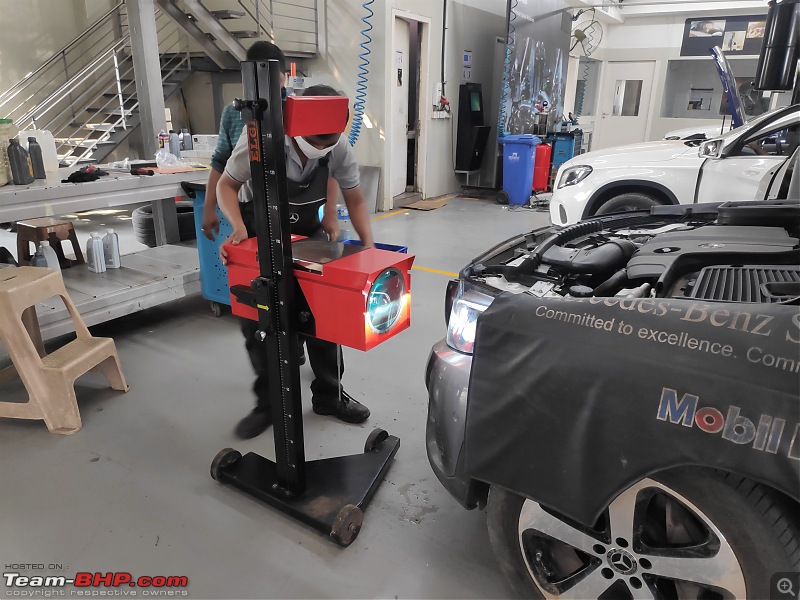

7. Headlight alignment
I have never seen this kind of apparatus, so it is intriguing.
The apparatus allows light to come in from that magnifying lens thing side and focuses it on a surface. The small red box on the top has a viewing slit to ensure the apparatus is parallel. It needs to be horizontal and we use 2 reference points on the engine bay for this. There is a spirit level gage inside also as a double check.
My Mercedes-Benz GLC 220d Progressive - Ownership Review-headlight-alignment-1.jpg
