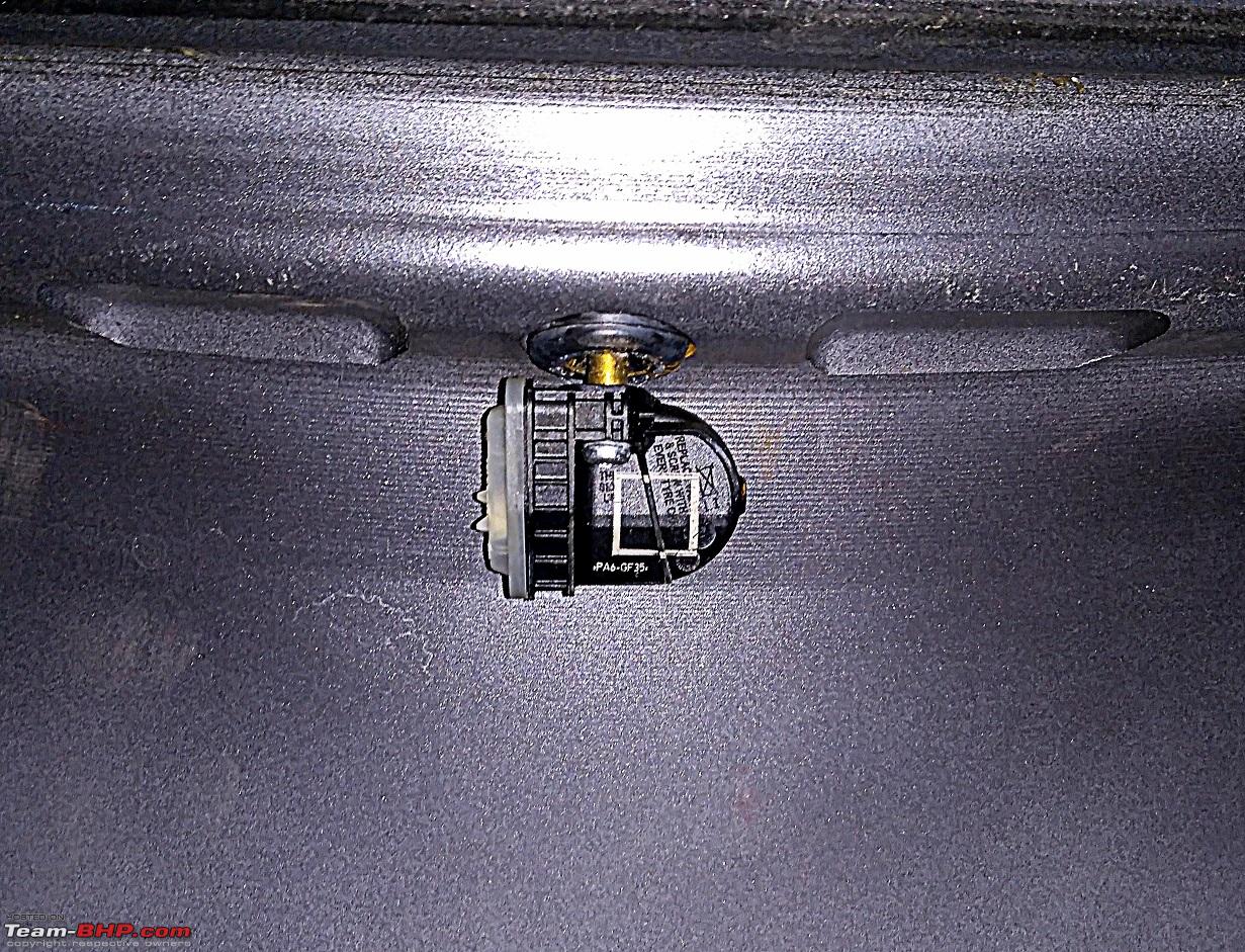

The TPMS uses proper rim mounted sensors.
The Built Tough Ford Endeavour 3.2 Titanium - Ownership Experience-t11_7.jpg
The readouts are available through FORScan, Ford's own IDS tool and even a common bluetooth adapter. I have even configured to show mine on the SYNC3 display (Refer this picture)

FORScan can read the Tyre Pressures. In the screenshot, you can see the Tyre Pressures and the battery behaviour at the time of cranking which I was additionally monitoring.
The Built Tough Ford Endeavour 3.2 Titanium - Ownership Experience-forscan_tpms_batt.jpg
A.G. is offline   (1) Thanks

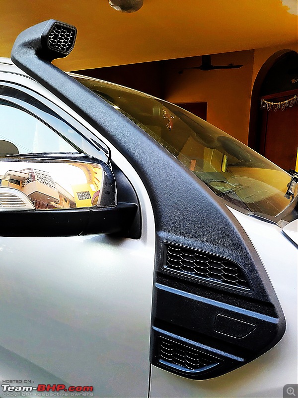

Getting the Snorkel
With the facelift, Ford introduced a couple of new accessories and Snorkel was one of them. While I do not intend to do river crossings, it was a long pending itch to have a Snorkel on one of our SUVs and what better than having an O.E. Snorkel. With this Snorkel being conceptualized with the Endeavour (Everest) right on the drawing board, the fitment does not require cutting any body panels and rather uses the existing vent / cavity for channeling the air. Even the lower part of the airbox is replaced to accommodate the side entry of the air as opposed to original part having air entry from front. The kit comes with a detailed guidebook making the fitment little bit easier.

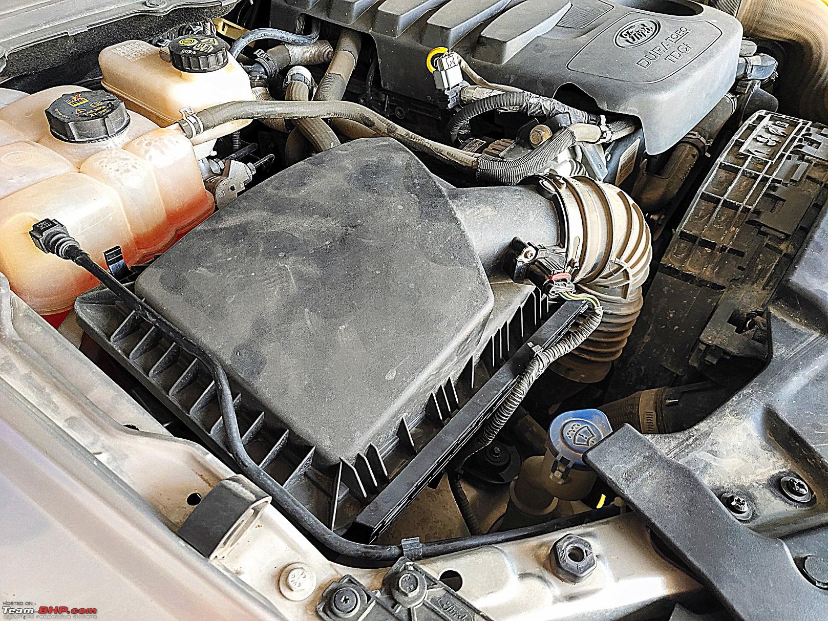

The contents (lower part of the airbox was in a separate box)
The Built Tough Ford Endeavour 3.2 Titanium - Ownership Experience-endeavour_snorkel_1.jpg
Original Airbox removed
The Built Tough Ford Endeavour 3.2 Titanium - Ownership Experience-endeavour_snorkel_2.jpg
Rubber plug covering the existing cut in the Engine bay to accommodate the parts of Snorkel
The Built Tough Ford Endeavour 3.2 Titanium - Ownership Experience-endeavour_snorkel_3.jpg
Side vent, Tyre and fender lining removed to access the cavity which will house the new tubing and mount for Snorkel
The Built Tough Ford Endeavour 3.2 Titanium - Ownership Experience-endeavour_snorkel_4.jpg
Inside view of the space
The Built Tough Ford Endeavour 3.2 Titanium - Ownership Experience-endeavour_snorkel_5.jpg
Bracket to hold the Snorkel on fender riveted after applying surface treatment
The Built Tough Ford Endeavour 3.2 Titanium - Ownership Experience-endeavour_snorkel_5a.jpg
2 brackets to hold the Snorkel from the top are supplied – the one to be used on Endeavour (Everest) is the lower one
The Built Tough Ford Endeavour 3.2 Titanium - Ownership Experience-endeavour_snorkel_7.jpg
The most challenging part in the entire fitment is mounting this bracket below the driver side roof rail. To remove the roof rail, the headliner needs to be lowered along the entire length of the vehicle which then yields access to bolts securing the roof rail in place. Once the roof rail is removed, the bracket is fitted below the roof rail and to have a flush fitting, a notch needs to be slightly trimmed.
Bracket fitted below the roof rail
The Built Tough Ford Endeavour 3.2 Titanium - Ownership Experience-endeavour_snorkel_8.jpg
With the roof rail fitted back, this is how the bracket looks
The Built Tough Ford Endeavour 3.2 Titanium - Ownership Experience-endeavour_snorkel_9.jpg
New airbox with side entry installed
The Built Tough Ford Endeavour 3.2 Titanium - Ownership Experience-endeavour_snorkel_10.jpg
View of the Engine bay with no front entry in the airbox

Front view of the Snorkel – while its not visible, there is an insulation pad between the Snorkel and Fender to damp any vibrations so that there is no noise
The Built Tough Ford Endeavour 3.2 Titanium - Ownership Experience-endeavour_snorkel_14b.jpg
Side view
The Built Tough Ford Endeavour 3.2 Titanium - Ownership Experience-endeavour_snorkel_14c.jpg
Gap between pillar and Snorkel
The Built Tough Ford Endeavour 3.2 Titanium - Ownership Experience-endeavour_snorkel_14d.jpg

Pardon me for asking a dumb question but that Air intake is facing the front on top without anything guarding to stop heavy rain water getting in to the pipe.
How does the machanism work to avoid heavy rain water from getting into the Air Filter?
I guess for the stock intake, the front bumper acts as a barrier for heavy rain water getting into the intake.

Snorkel heads are designed not to allow even torrential rainwater in. The only thing that one has to be careful is while washing the vehicle with a pipe or jet washer, taking care not to directly stream water at the snorkel head.
I usually would cover the snorkel head with a plastic bag while washing the vehicle with a hose to prevent accidental spray directly into the snorkel head.

Update: There is usually a little water that does infact enter the Air Filter Box which has drain holes to allow this water to drain out. The actual Air Filter sits a little higher so that little amount of water does not get it wet.
One should regularly check to make sure that
these drain holes are not clogged else water will enter the system.
Snorkels are not foolproof by any means for deep water crossings. The main purpose for installing one is to get cool clean air from the raised intake. Engines love cool clean air..specially big diesels.
For short periods of submersion a Snorkel will help ofcourse but for longer periods in deeper than 800 millimeter water, it will not be able to do much as water will enter the system from the drain holes in the Air Box.
For deep water crossings one has to ensure the whole system is well sealed including the drain holes in the air box. Breathers also have to be mounted high up in the engine compartment for the gear box and differential.
https://www.team-bhp.com/forum/attac...snorkel_10.jpg
I did not notice any drain holes in the pic of the Air Box posted by A.G. though.
Apart from this the alternator and electricals also have to be protected from water.
The Endeavour comes with 800 millimeter wading capability which is quite good. This means that the Air Box, Breathers and Electricals are protected up to that depth as standard.
A snorkel addition while very helpful for getting cooler cleaner air into the engine will not add much in terms of increasing the 800 millimeter water wading depth.
Ofcourse the aesthetics being enhanced are another positive but that is again a subjective matter.
Some people mount the Snorkel head facing forwards while some prefer it facing back. The Gurkha comes with a snorkel fitted from factory with the Snorkel Head facing backwards.
