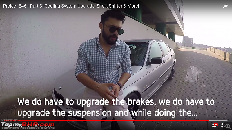

The video starts off with a description of all the parts going in. I overhaul the cooling system (ECS Tuning Level 3 Kit) this is a precautionary measure highly recommended for the E46 as the cooling parts (Plastics, hoses etc) degrade over the years, Short throw shifter, New OE AC Parts to make it function back at 100% levels, Air Intake (aFe Magnum Force, stage 2) & more...
My 2001 BMW 328i (E46) build thread | EDIT: New video & upgrades on page 15-screen-shot-20180304-7.20.06-pm.png
DO NOT Miss this segment where i demonstrate how good the Gearshift quality have become;
My 2001 BMW 328i (E46) build thread | EDIT: New video & upgrades on page 15-screen-shot-20180304-7.16.02-pm.png
& finally on whats to come ...
My 2001 BMW 328i (E46) build thread | EDIT: New video & upgrades on page 15-screen-shot-20180304-7.17.36-pm.png
