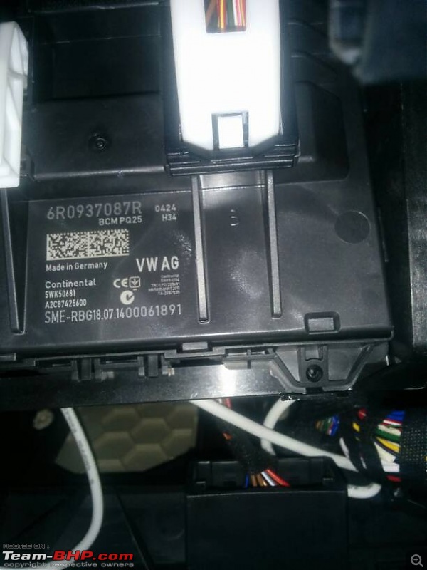

The Rapid 1.5TDI comes with Cruise Control. Is it possible to retrofit this system in the Polo 1.5 TDI?
Check the posts by Gannu in the Vento thread. Does the rapid manual also have cruise control or only the DSG?
As per Gannu the Vento TDI DSG uses the same BCM as Rapid and cruuse control can be retrofitted by changing the stalks.
Sankar, if the BCM part number ends with 087, it supports cruise control and you can do the retrofit yourself. Just needs a change in the left stalk and a couple of cables to be connected to the BCM/steering module and the ECU through thru firewall. I haven't done the mod since mine comes with a medium BCM (ends in 086) so requires a BCM upgrade first.
I've summed it up here.
This is the new Vento 1.5 TDI DSG's updated BCM (note - made in India by Continental). Thanks to BHPian rejeen for the snap.
And the new Rapid 1.5 TDI DSG gets the imported Continental BCM from Germany (thanks to BHPian charansuki for the snap; link).
Can you let us know what BCM the new Polo 1.5 TDI comes with? TIA.
Thanks Gannu. I bought a new GT TDI and is getting myself aquainted with the new car.
Where should i look for the BCM in the car?
Edit: Got it!

Thanks Gannu. I bought a new GT TDI and is getting myself aquainted with the new car. Where should i look for the BCM in the car?
First off, congrats!
Check this post. I've mentioned how to locate the BCM.
Do post back with a snap!
EDIT: I am eagerly hoping for a 087 model. Doesn't matter if it is imported or made locally.

Even i was hoping and wishing that the car gets an updated Made in India BCM if not the German unit. But guess what? Its 87R and its Made in Germany
2014 VW Polo 1.5L TDI: Test-Drive Thread-20150401_185234.jpg

Haha that's awesome Sankar! Man, I wonder who's in charge of the parts bin for VW cars. The more expensive Vento 1.5 TDI DSG gets a made in India BCM and the cheaper GT gets the imported one!
Anyways, you are set as long as the BCM is concerned. What you now need is the left stalk set that supports the cruise control and the associated harness. The harness comes with wires which goes to the BCM plug, fuse box and ECU. Rosstech doesn't mention the ECU part in their link but other DIY'ers do so I am going to take their word for that. I couldn't find a complete guide on this just bits and pieces. Google search for Polo 6r cruise control.
Sankar, please buy a VCDS cable ASAP! This will help you in tweaking and doing the diagnostics from time-to-time.

Since the BCM part is now clear its good to know that option is open and can be done. I will read up on the cruise control retrofit.
