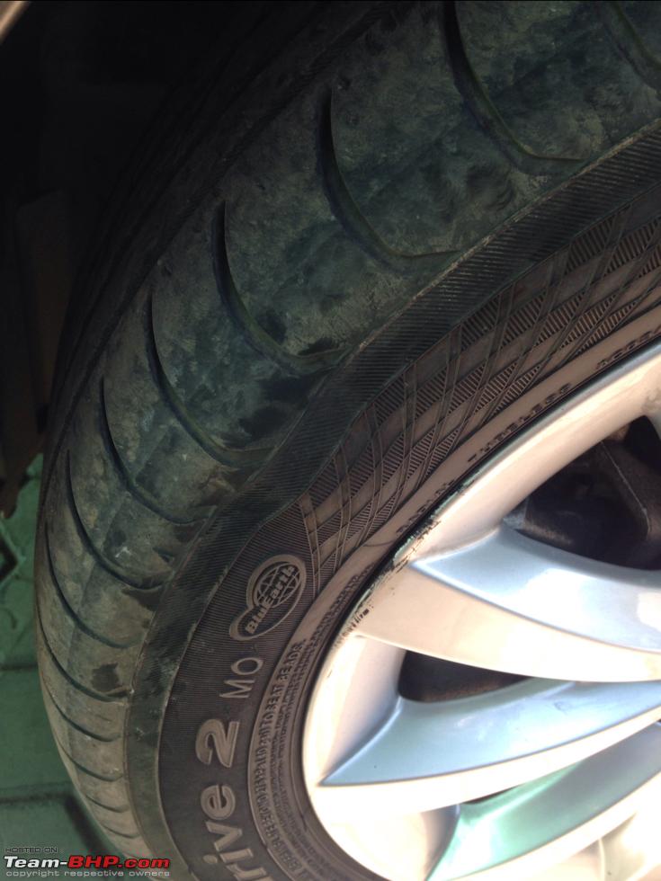

Little bit of rotten luck today
The car went into a pothole at about 50km/h and the tyre sidewall now has a bulge in it.
I am not sure if I should replace the tyre. Any suggestions from the forum?
Is the damage that bad to need a replacement?

My commiserations. I had a similar incident and did end up replacing the tyre. I'd advise you do likewise as it seems the structural integrity gets affected once a bulge like this develops. Don't risk it.

Yes, that tyre is definitely an urgent replacement job.

The marks on the rim shows the wheel took a pretty nasty hit. And yes bulged sidewall is a bad thing to have in any wheel. If you took the extra coverage from MB you can claim it. i have taken the tyre replacement protection.

Change the tyre asap like others have mentioned. Seems like it was a bad hit. Also get the rim checked for any damage when replacing the tyre.

Thanks Akshay. I got a new Vredestein.
Luckily the rim was good and there were no damages to it.
While I was at the tyre shop, the owner suggested that he could repair the tyre by essentially putting a patch on the inside of the tyre where the tear (and hence the bulge) had occurred. Has anyone done this sort of repair?
He was quoting around 2200 bucks for the repair job.
