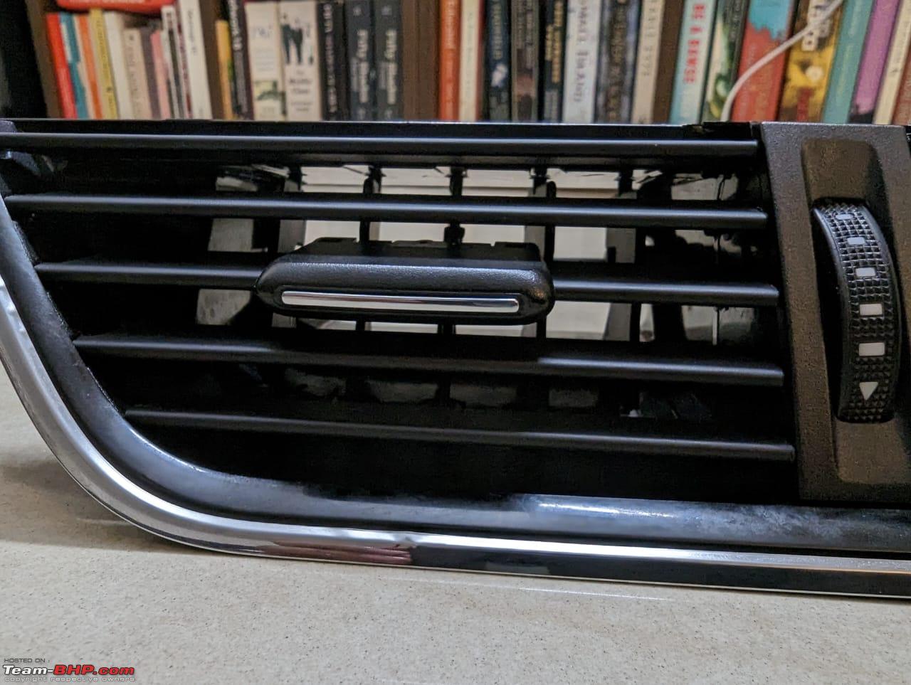

Fixed the broken AC vent on my own
Not sure if it's just me, but the AC vent slats on VAG cars are brittle! The vents on my 2011 Vento TDI kept breaking, and then my 2019 Octavia.
Background
One of the vertical slats on the driver-side AC vents of my 2019 1.8TSI L&K broke within the first year. Over the years, it broke one after the other until all of it was gone. It had become impossible to get the AC to blow towards the driver.
It's obviously not covered under warranty, and the ASC quoted some 9k for it. I checked the same on Boodmo and it was available for 3.5k so I ordered it.
My plan was to take it to an FNG but decided to try my luck removing it on my own because I didn't care even if it shattered into million pieces. I just wanted to make sure that the dashboard housing did not get affected. If I could remove it, I could install it too. Logic.
I followed the first link on YouTube to figure out how to remove it, and it was fairly straightforward. It is a simple task as long as you have the right tool. So I got the right tool from my kitchen - 2 steel forks.
Simply clever design
The reason for the slats to break is that their supporting plastic breaks off. But Skoda has a simply clever feature to capture these broken pieces. I was able to find 4/5 pieces from the small storage below the steering wheel (I remember throwing away the first piece because I couldn't figure out where it came from).
Review: Skoda Octavia (3rd-gen)-whatsapp-image-20221128-17.35.22-1.jpeg
Review: Skoda Octavia (3rd-gen)-whatsapp-image-20221128-17.35.22.jpeg
Why did I fix it?
I had some free time on a Friday evening and I was curious to see the engineering behind it and why it cannot be fixed. I had no reason to worry thinking 'what if I broke it more?' because I had ordered a new one anyway. So I sat with some plastic knives, forks, screwdrivers, etc and started fiddling around.
How did I fix it?
I thought I could superglue it into place, but the angle was such that I couldn't get a clear point of entry. So I just used paper tape. However, I had to remove all the horizontal slats to gain access to the inside. It was fun.
Review: Skoda Octavia (3rd-gen)-whatsapp-image-20221128-17.35.21-1.jpeg
Final look
After hours of fiddling around and with an equally enthusiastic friend of mine to help, we got it assembled. I cancelled the Boodmo order to see how long my paper tape fix is going to last. Unfortunately, I wasn't planning on writing a post here, so I didn't click photos of each stage.
Review: Skoda Octavia (3rd-gen)-whatsapp-image-20221128-17.35.21.jpeg
Suggestion to all owners out there
If you have the stomach to remove the AC vents on your own, I'd suggest that you do it and put tape below it as support. Preventive maintenance, you see.

Re: Fixed the broken AC vent on my own
Thanks. I'm doing it this weekend. I just never figured how to remove the vent.
Does this click method for removing also work with middle vents.
For my 2019 Octavia, only one flare of one vent is broken. But I would like to fix it! Also some preventive maintenance will not hurt either.

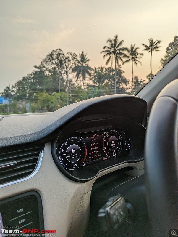

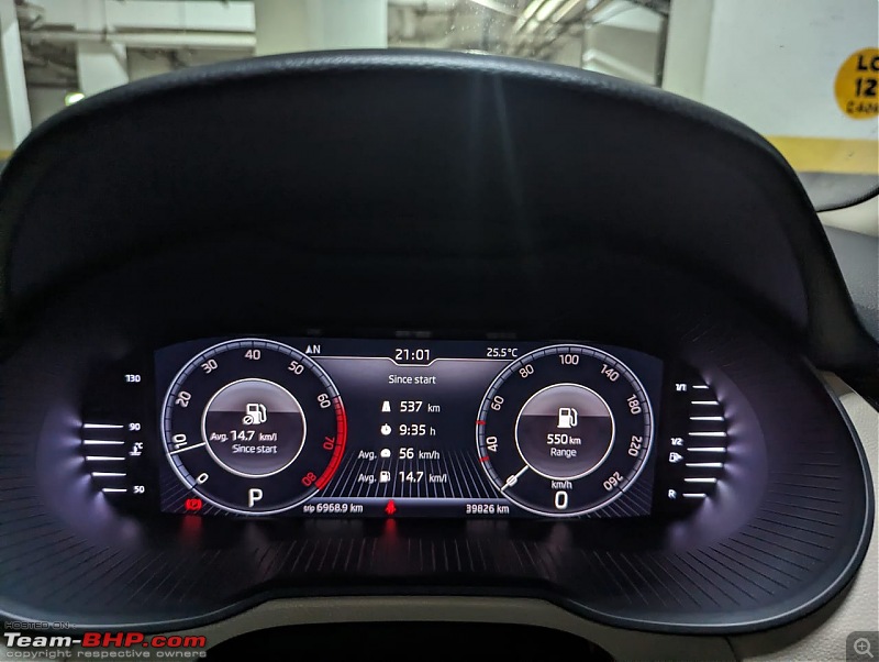

I've seen posts about FE of over 15 kmpl for the 1.8TSI and I never really understood how people managed to squeeze out that much. That's when I tried to test it out by driving my 2019 Octavia like it shouldn't be. Mellow.
The first attempt to test the FE was on my trip from Bangalore to Kochi in November. I drove below 110 kmph unless it was to overtake and cruised mostly between 90 kmph and 100 kmph. There were hardly any sudden acceleration that revved the engine past 2k or 2.5k RPM. I got a 15.1 kmpl in the first 509 km, and the last stretch with bumper-to-bumper traffic brought it down to 14.7 kmpl by the 537 km mark. That's still a pretty good number I'd say.
Review: Skoda Octavia (3rd-gen)-15.1.jpeg
Review: Skoda Octavia (3rd-gen)-14.7.jpeg

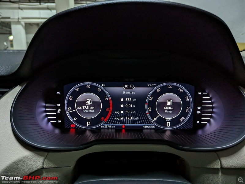

The second attempt was made again a few days ago, the same Bangalore to Kochi drive. This time, I was driving below 90 kmph most of the time, and I had my cruise control set at 87 kmph (87 because that's how fast I was going when I set it. It wasn't intentional and I didn't feel the need to round it off to 85 or 90). I also coasted as much as I could. I have no idea how people drive that slow in a German car. It was insanely boring, but I endured it.
Until I hit some traffic, I managed to reach a peak of 17.9 kmpl. At the 500 km mark, the FE was at 17.5 kmpl and just like the November drive, I hit bumper-to-bumper traffic. I contained all my urge to speed through the traffic with quick acceleration and stayed behind slow-moving vehicles. By the time I reached my destination after 532 km, the FE was 17.3 kmpl, which is INSANE.
Review: Skoda Octavia (3rd-gen)-17.5.jpeg
Review: Skoda Octavia (3rd-gen)-17.3.jpeg
I sent the photo to my friend who owns a Honda City and he cursed me and asked me how much would a used Octavia cost. I sent him some OLX links.
It should. Even though it might be trickier as you need to simultaneously handle 4 clips. Apologies for the super late reply. I missed this message.
