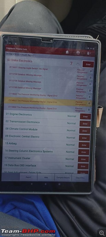

Originally Posted by revsperminute View Post
The head tech hinted at a problem with the ABS module saying some data was ‘missing’.
Got a screenshot of the codes. Can anyone make any sense of it?
Review: Skoda Octavia (3rd-gen)-a88ba466d8154c4499073a701d01fc3f.jpeg
revsperminute is offline
Old 10th September 2022, 21:20   #5196
revsperminute's Avatar
Join Date: Nov 2018
Location: Navi Mumbai
Posts: 335
Thanked: 1,300 Times
Re: Review: Skoda Octavia (3rd-gen)
The issue has been resolved for now. The workshop cleaned and reinstalled the ABS control module and multiple other electronic components. What stood out to me during this ordeal is the workshop’s response. Vicky Car Zone in Navi Mumbai has been an absolute dream to work with. Prompt responses, fairness and top quality work, they’ve got them all. Vicky the owner went as far as assuring me that I can pay when I am satisfied with the resolution. I left my car with them and they did the work within 6 hours. No wonder their premises is flooded with luxury cars of all makes and models. 11/10.
