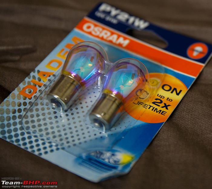

Fitted the Philips Silver Vision indicator bulbs . The headlamp cluster looks clean now without the orange indicator bulbs. I bought the bulbs from powerbulbs.com, they had a 20% discount and free shipping offer. It took exactly 6 days for delivery.
Some images:

Also got a pair of OSRAM Diadem indicator bulbs
