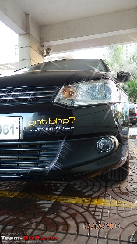

First car wash after change over and in 8 days, so much for scarcity of water, knowing that tomorrow is Holi. Hoping The Dark Knight remains spot free after Holi. Will need to wash it all over again, damn.
Washed it with Amway car shampoo, which made the surface quite smooth(80% as smooth as ONR) and than a quick detail with ONR for the shine. Another new thing I learn't is that, never put shampoo first in the bucket and then water, which results in nothing but foam, instead put the shampoo after you have filled up the bucket and stir it with your hands.
Some snaps after the wash.

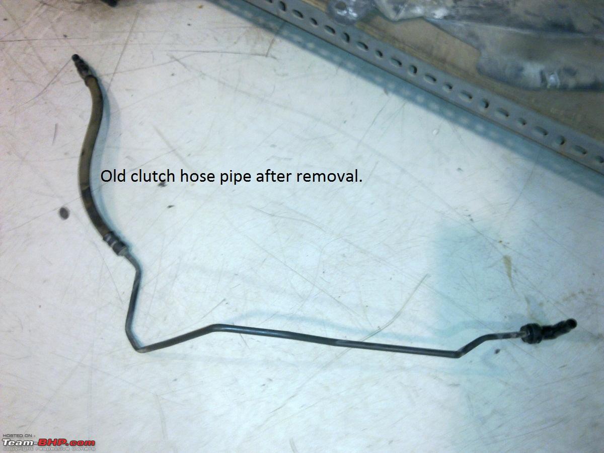

Problem: Yeah, only one but the most irritating.
As most of the VW Vento TDi owners might be aware of the hard clutch of Vento, so I had asked the SA that I need the replacement for the same under warranty FOC(Free Of Cost). SA told me that it needs to be looked up and we need to then send a DISS to VW for the part. I told him that one of my friend had got the same done on his Vento and that too FOC.
I gave him the part number and asked him to have it in stock when I would be coming for service. All this was done when I scheduled the service.

Later I see the car mechanic Mr Ajit who is attending my car is fiddling, yeah that what was my impression something inside the rear of engine. I ask him what are you doing.
The reply I get is "Changing clutch hose pipe". I asked him, "Really?"
He replied with a big "Yes".
Mechanic accepted that the clutch is hard on Vento and the part is replaced if customer brings it to notice. So finally it has been done. He removed the old clutch hose pipe and drained out the old brake fluid onto the floor. Yes, he didn't put anything underneath. I asked can I see the new clutch hose pipe, the thing which I was looking forward to. Verified the part number from @Ricky_63 Vento's bill. It's same.

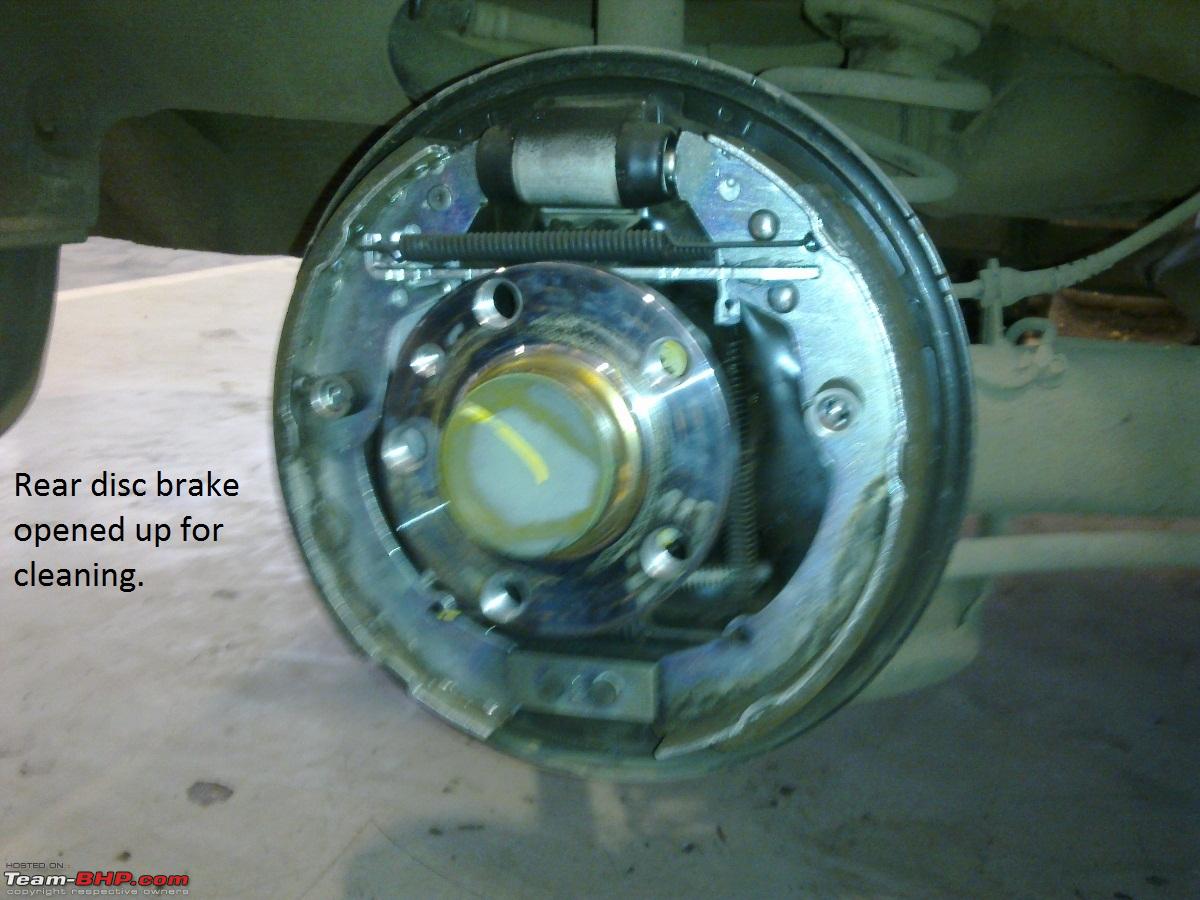

Next thing, cleaning the brake pads and putting back all the wheels back onto the car. Again I disappear from the prying eyes of manager.

By 5:30 pm all done. Thanked SA and mechanic for the work and especially for the clutch hose pipe and said to the SA that few of my T-Bhpians friends might be coming over to get the same done on their Vento. Handed over the gate pass to the security and I was off to my home sweet home.

1. Drove 6 kms from the workshop till my house, clutch felt really soft. Oh yeah, at last. In coming days with more kms on the odo, clutch should get more smoother and I'm not complaining.

Dark Knight has arrived! VW Vento TDi Highline. EDIT: 5th Service done-old-clutch-hose-pipe.jpg

Dark Knight has arrived! VW Vento TDi Highline. EDIT: 5th Service done-rear-brake-opened-up.jpg

And that's a drum brake, in the last image.

Drove my car today for 30 kms and I must say, my Dark Knight fells very different. The clutch is way smooth now and no more hard clutch problem. The biggest problem I used to face while changing from 1st gear to 2nd and many a times there used to jhatkas, which is not the case now. Clutch pedal goes in and releases very smoothly. My left leg is feeling all the more happy.
I definitely recommend all the pre-refreshed Vento TDi owners to have clutch hose replaced FOC under warranty, you all would be surprised by the difference it makes.
The parts replacement weren't obligatory and one can continue with the previous clutch hose pipe. Only when bought to notice, VW will replace under warranty. Neither of the parts have any affect on the car in long term.
Actually I liked VW as it is replacing the parts knowing older ones don't cause any troubles.
I made a typo and wrote it as disc, it's the drum brake at the rear.

When you mentioned about the hard clutch, was it only the hardness of the clutch pedal or did you have the "hiss" sound also as Ricky reported? I was given to understand the change was only when you had the noise and not otherwise.
The clutch was hard since first day and my dad even complained to VW dealer about it and they passed it saying it is so in every car back in Apr'11.
While releasing the clutch, in the end it used to cause jerk and I really had hard time learning to release it softly. And while pressing the clutch I could hear a grinding noise which even made the problem more aggravated and replacement necessary for me.
After reading Ricky post, I was sure if I did pursue the matter with the SA he might oblige and with the bill from Ricky post & part number, it made it all the more easy to put forward the case.
Originally Posted by bala80 View Post
Your post seems to indicate that the change is being done irrespective of whether there is noise or not. Is my understanding correct?
Yes, if you feel the clutch is hard while depressing and releasing it and hear a grrr noise while pressing, let your SA know about and pursue it with saying my friends too have got it done and I have a bill for the same. SMS the part number to him. That's what I did and got it replaced FOC.
If so, what's preventing VW from pro-actively changing it rather than waiting for the customer to report the issue? With the knowledge level of people in the service center here, it is very difficult for us to even make them accept this in the first place.
VW knows that without changing the part, it won't cause any long term effect on the car. As if I don't get the engine mounts replaced, it wont cause any problems. Likewise I didn't get door beading replaced, no problems and no noise touch wood.
I got lucky I did say and with bit pursuance did the work. Even the mechanic in the workshop who was working on my car accepted that there is harshness in the clutch of Vento TDi and replacing it with new one resolves the problem. I don't get any more jerk even if did release the clutch I use to did in beginning of ownership and overall there is tremendous difference which warrants the change.
Try calling the workshop and explain the case and tell them the part number too(6R2721465R), they will definitely address the problem. And when the clutch pipe is changed they even change a hex plate and a screw all FOC.
