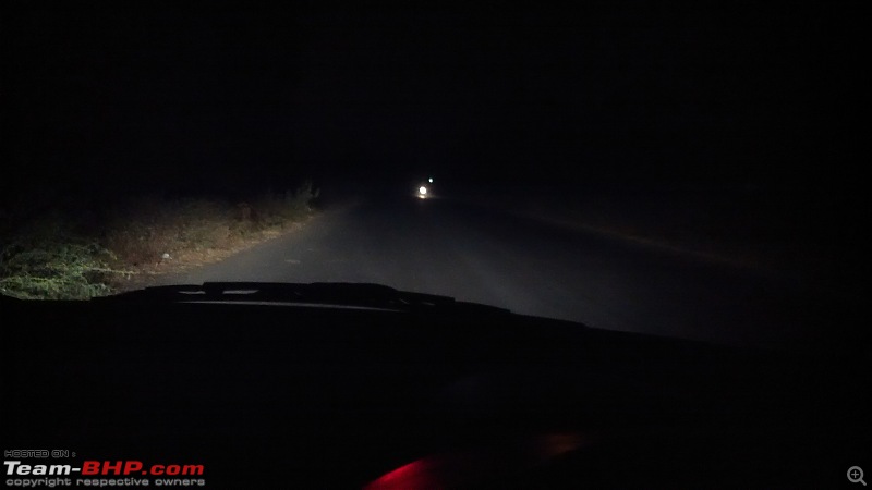

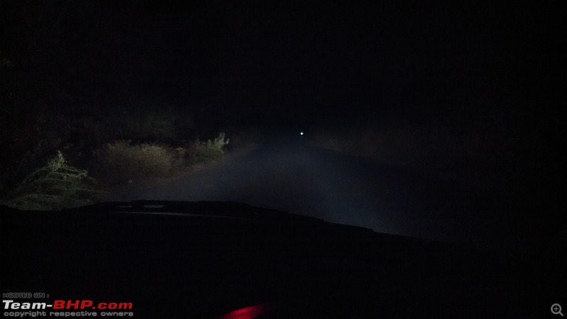

Tonight, realized that the over smart guys have messed up with the headlight alignment which earlier was simply excellent for me.
Now the beam is as useless as it was in my Grand i10. The blackness ahead of RH side has returned. I am damn frustrated. Now, I will be spending 5-6 evenings to get this thing corrected myself. The very purpose of buying this car was peace of mind and my personal safety, comfort. Mental comfort they have already eaten into along with safety with such useless light setting.
To highlight my point, I am attaching images which I took tonight on a dark, deserted road. The car was stopped before taking the images.
Only Fog Light. Wonder why all the 70W are going.

Only Low Beam, you can clearly see that the blackness in front of RH headlamp and overall light pattern are not good. Its very easy to miss stones of road divider which are often fall off or any obstacle.
Review: 2nd-gen Maruti Swift (2011 - 2017)-only-low-beam.jpg
Only High beam. Almost pointless to use them.
Review: 2nd-gen Maruti Swift (2011 - 2017)-only-high-beam.jpg
Can anybody tell me how to do the horizontal alignment ? Vertical alignment I am aware of, but not Horizontal.
This car is now useless for night drives. Thanks Maruti and Kiran Motors for make feel as if I have wasted my hard earned money.

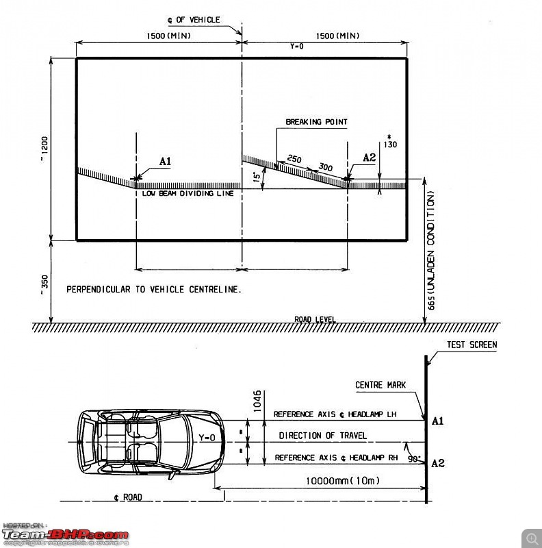

Along with those horizontal adjustment, another thing that came in very useful was an image about specific adjustments. Attaching that image too which mentions alignment distance and optimum range.
After this, the ride tonight was simply awesome. The particular benefit is from high beam, where as low beam is also now better, atlesat more driveable.

I upgraded from Philips Xtreme vision plus bulbs to Philips rally 90/100 W bulbs. This was done along with wiring upgrade, the wiring kit and relay from Lumax. The throw is nice, but the focusing is gone all wrong. This should not happen as the bulbs are regular H4.
Attaching a few images where the wiring is dressed, low beam and high beam.
As far as vertical alignment goes, with Philips Rally, my headlamps don't have a firm \___\___ throw profile as indicated in the image. Is this focusing problem or poor reflection due to fake bulbs ?
High beam needs horizontal alignment which is a very tough process for me.
I ordered the Philips Rally bulbs from Ebay and they did cost me Rs. 555/-.
Did anybody need horizontal and vertical alignment after installation of Philips Rally bulbs in Swift ?
Else, I would either go back to Philips Xtreme vision or get Osram Bilux 90/100W. As the throw profile lacks \___\___, I am not able to adjust the beam correctly ( and don't want to blind oncoming traffic with poor approximations ). Also, current settings are perfect for Philips Xtreme just in case I have to revert back.
The wiring dressing
Review: 2nd-gen Maruti Swift (2011 - 2017)-img_20160125_171304.jpg
Low beam only. \___\___ is not achieved
Review: 2nd-gen Maruti Swift (2011 - 2017)-img_20160127_193612.jpg
High beam. Dark spot in front center.
Review: 2nd-gen Maruti Swift (2011 - 2017)-img_20160127_193618.jpg

From what I can see posted in the pictures, the left headlight does actually give the "\___" whereas the right one isn't that pronounced. Can you interchange the bulbs once and see?
Also can you post a picture of the box in which you got these bulbs?
