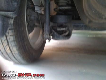

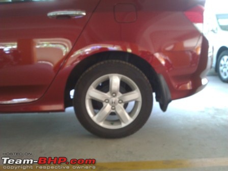

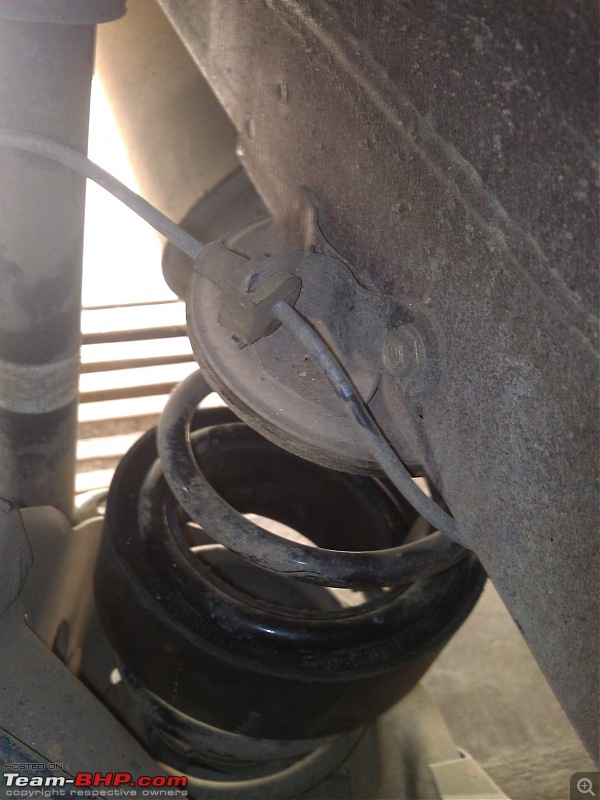

Got the coilspring spacers installed on the rear side of my ANHC (Dec 2008) with about 50k KMS on it. The suspension feels saggy, but want to give a try if it helps avoid scraping hyderabad potholes and speed bumps.
Product: Superior 18-1901 Donut Style Coil Spring Spacer
Issue: As you can see from the first picture, the Car's coil spacing is more than 1.5" the thickness of the rubber spacer. hence i had to place it and lower the car to have it fall in place. Need to figure out if i need to tie them with a Nylon Cable Tie.
Picture 1: Car lifted up with no load. Is it normal to see sagging coil?
Picture 2&3: After installation
The ride feels a bit higher than normal with no change in road dynamics. I have not yet tested on Hyderabad speed bumps and pot holes yet. Will keep you posted.

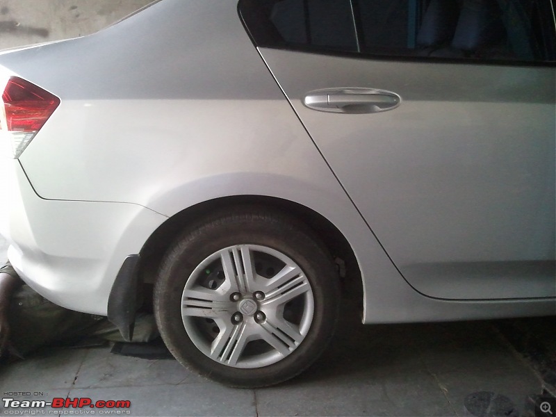

Here are the pictures of before and after installation. Sorry for the rather poor quality from the camera phone
Left Rear wheel (before mod)
Coil Spring Adjusters : VFM Fix for the Honda Civic's (lousy) soft rear suspension?-before.jpg
Left Rear Wheel (After mod)
Coil Spring Adjusters : VFM Fix for the Honda Civic's (lousy) soft rear suspension?-after.jpg

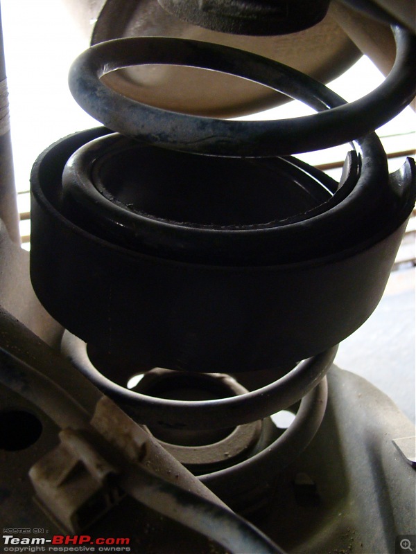

1) Brand is Superior & height is 1.5 inches. See Pics below. I purchased them from a very nice BHPIan - Hansi (also on this thread & courtsey for the pictures too) who had bought it earlier from Amazon.
Coil Spring Adjusters : VFM Fix for the Honda Civic's (lousy) soft rear suspension?-superior1.jpg
Coil Spring Adjusters : VFM Fix for the Honda Civic's (lousy) soft rear suspension?-superior2.jpg
Coil Spring Adjusters : VFM Fix for the Honda Civic's (lousy) soft rear suspension?-superior3.jpg
2) Yes, we had to remove the rear wheels one at a time to install the mod and No, I did not tie them up. I don't think there is a need to tie it up with a nylon tag since it fits in very well in there once the car is on the ground. see the pictures taken this morning (excuse the poor quality of cell phone camera)

Just updating the thread after driving about 1900+ KMs with these spacers. The conditions were
a. Fully loaded trunk - Yes literally fully loaded with no space at all.
b. One car seat, 3 adults in the car with some extra luggage under the seats
c. Very heavy rains.
d. Unbelievably Potholed roads as well as best highways (Hosur-Salem road by L&T)
Results:
a. No scrapes at all, except once slightly because of a very oddly build ramp. (I expected a scraping while crossing over)
b. Didn't scrape at all while crossing speed breakers in Bangalore where the car always used to scrape or the mudflaps would touch with loaded boot or with 4 passengers
c. Car felt well planted on road at high speed (maybe due to the weight). No difference felt in handling on highway or otherwise. Max speed touched on L&T roads - 160 KMs
d. With 5 people and few luggage in boot, the ride was smooth as silk on some uneven roads.
