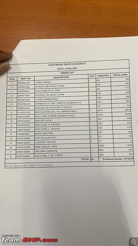

Hi All, I have been hit with a massive bill for 2.5 Lacs for repairing my Honda accord 3.5 V6. It suffered with a rat bite and I gave it to a FNG to get the wiring repaired. It was repaired however traction control warning was lit up. After that I didn't used the car for few months , and now when I took the car out , it started giving ABS error as well. So , I decided to give the car to Honda ASS for repair and they have given attached estimate. They said the ABS module stopped working due to incorrect wiring by FNG.Few queries
1. Can I delay the change of VSA modulator, what are the implications of this
2. Not sure about the power steering issue which has given in estimate , can I keep on refueling steering fluid in pump and drive the car.
Can someone help with a good FNG in pune who can repair this VSA and steering assembly otherwise I will have to get it repaired at Honda ASS only. Thanks

Attachment 2582865
VSA module can be delayed your cars ABS will not work at all you can also purchase used part from Delhi mayapuri market but you will have to go there to find part which is difficult because you live in pune try to find used module in pune.
Ask ASC to change oil seal kit of power steering it will cost you less Honda provides oil seal kit too for power steering gearbox Overhauling it costs very less.
I am sure you have used aftermarket or generic power steering oil as using non Honda or Honda compatible power steering oil damages and swells oil seals of power steering.
My 7th Generation Honda Accord Power Steering rack was damaged because I used generic ATF but I got lucky I found 2015 manufactured used Steering Rack for just 12500 INR in Mayapuri Delhi.
