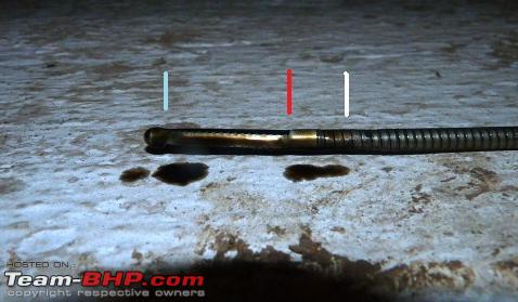

Quoting from a very old post but was stuck with extra oil inadvertently filled when I tool my Dzire for service. here is a pic of the excess oil on dipstick min max and actual level is shown by lines.

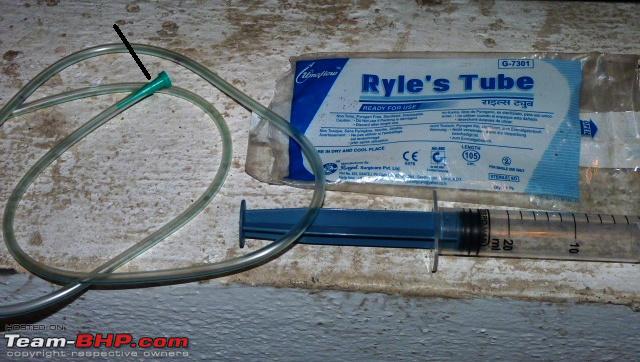

I bought a Ryles tube from a chemist along with a 20 ml syringe. (Incedentally, Ryles tube is for passing into a persons stomach to put in or pull out stuff)How harmful is extra Engine Oil?-p1030539.jpg

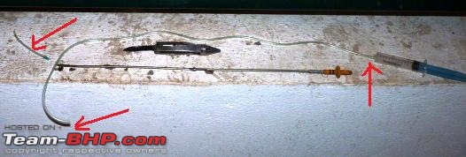

Cut of 4-5 " from end of the ryles tube as it has 3/4 perforations on the side wall. So now I have a tube of about 4-5 mm thick and a bit longer than my dipstick. How harmful is extra Engine Oil?-p1030540.jpg
Slide the ryles tube into the dipstick tube, fix the syringe at the other end and pull the syringe plunger. Here I have shown the oil just about to enter the syringe. How harmful is extra Engine Oil?-p1030541.jpg

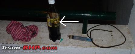

Finally took out about 250 -300 ml. Careful in handling as the oil is very messy if it falls. PS I had a person helping me hold the soda bottle.How harmful is extra Engine Oil?-p1030543.jpg
