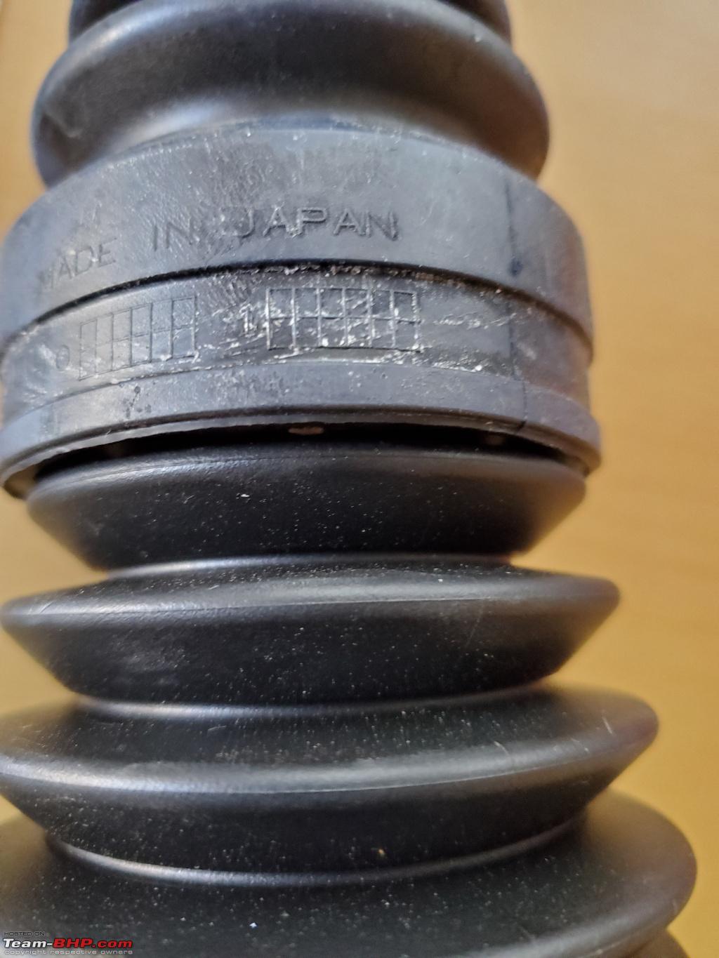

Thanks for this detailed post. While waiting at the service center, I read your post and decided to go with a replacement shaft for my Astar RH driveshaft instead of a repair.
In spite of being aware and prepared with a replacement CV boot for a minor leak on the drive end boot well in advance of any damage to the shaft bearings, I will have to spend Rs. 5500 instead of a cheaper boot replacement!
Driveshaft / Axle Maintenance-astarservice3.jpg
Why? If it's only boot which has cracked/leaked then you can safely replace only the boot(unless your CV joints are bad)
Leoshashi is offline   (2) Thanks
Thanks for quick response!
Hmm... That's what I thought! The workshop mechanics seemed very hesitant to open up the boots and replace them! They were not confident about doing the job. The works manager said they had not done it in years - standard procedure was replacement. He said the clips required special tools (and he didn't have them). Should I try a different MASS?
Definitely. If you have the boot then no need to deal with them. Even FNG/road side mechanic can change the boot.
Secondly you don't need any specialized tools for the same. A pair of needle nose plier is all you need and I don't believe a MASS won't have it. Boot replacement is a messy, time consuming and not so paying job, so your MASS isn't interested. Driveshaft replacement is less messy, quick and quite rewarding too, so they are preferring that.
Shashi
Got the boot replacement done (only drive side, because they said the wheel side was hard rubber compared to the other side and recommended some 3rd party boot which I didn't want, in any case the wheel side boot was perfectly fine). These guys are specialists in drive shaft repairs (see pics). The mechanic expertly removed the shaft from the car with basic tools, fitted the boot in minutes and everything was done within an hour. Labor charges 300.
(I provided the spares and grease). Hope this lasts.
