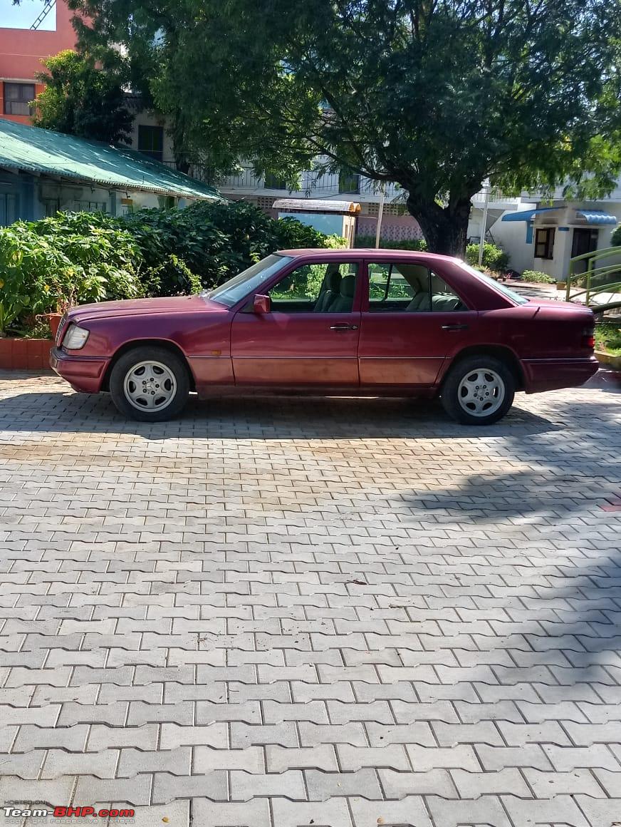

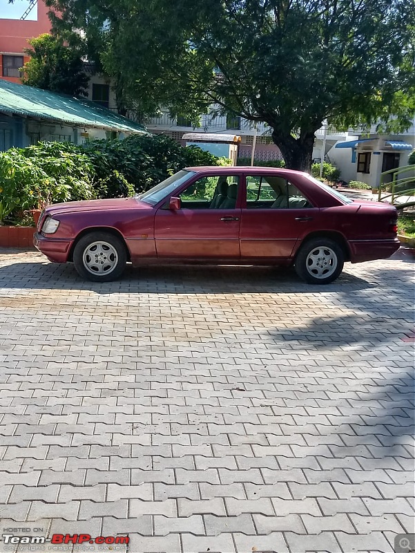

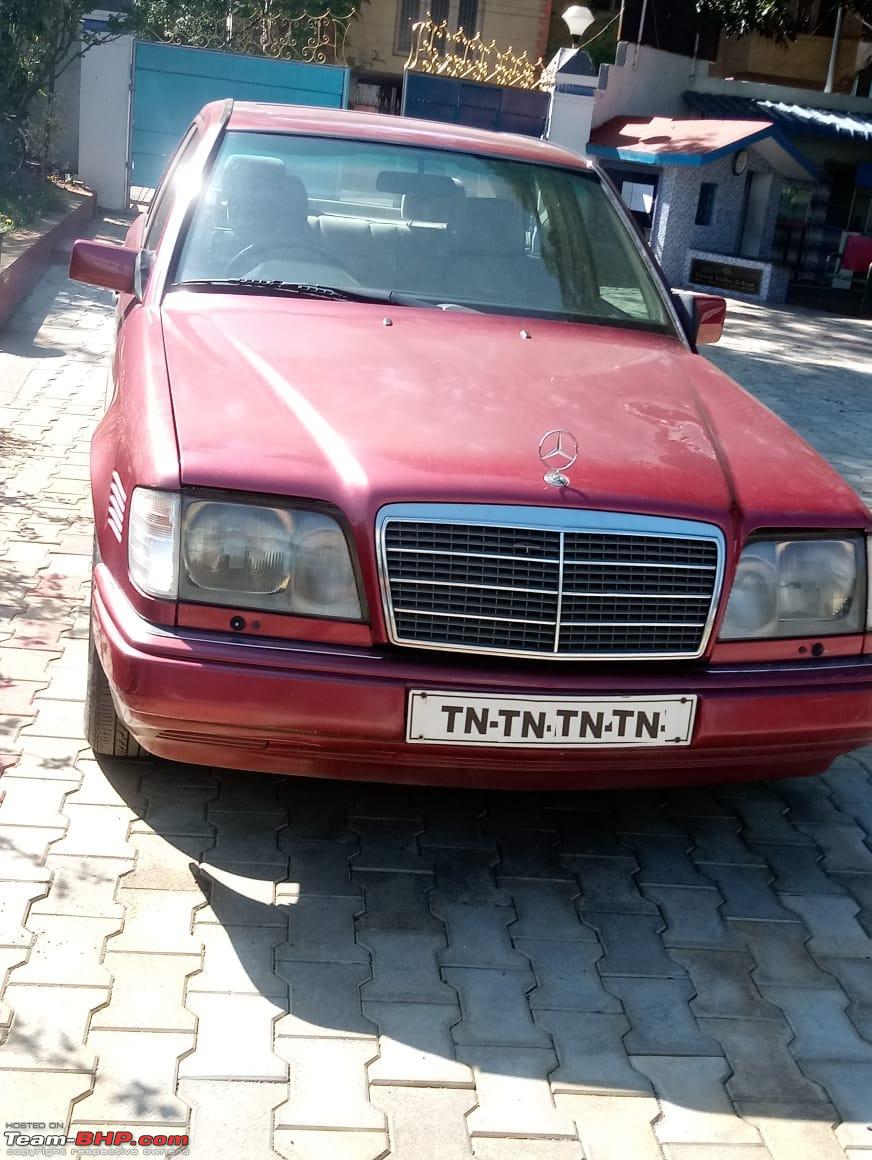

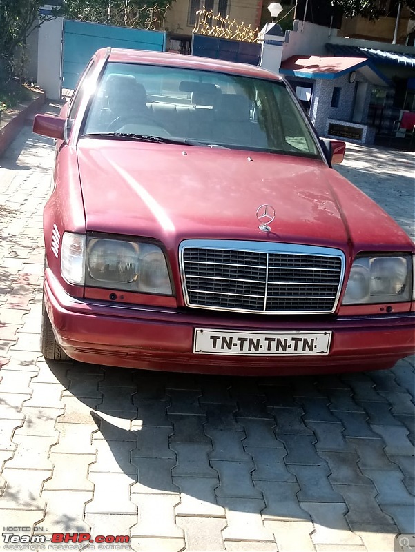

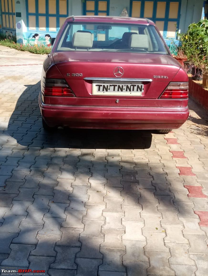

Hi Friends,
after years of Hunting, finally going to have this beauty in my Garage! I want to keep her stock. This is a 1993, E 300 Diesel Automatic! Genuine 70,000 KMs
This Car was in Delhi till 2003 held by an embassy and then came to its current owner a septuagenerian Doctor couple who have been associated with the embassy, They have been owning only Mercedes cars from 1970. This car was Re-registered in TN in 2003. I fell in love with it once I saw the badge "Made in Germany" - That brought a huge Grin on my face.
I drove the car for a short distance and this was the second automatic I'm driving (My first automatic was Harrier, test drive). The owner and me were chauffeured for a long drive including a highway drive, I fell in love with it again, Man it was a rocket, Its rear seat comfort, was so good, I wanted to be chauffeured in this car.
The car is maintained by a trained mechanic closer to my home It was maintained by his father and now the son handles the car. They know every bit and pieces of this car. I'm happy again!!
The owner assured the car was accident free and every part and panel is original
This car may come home in 2 or 3 days, as I have made the payment in Cheque.
Coming to the negatives, as observed by me and also stated by the current owner:
1. The engine oil seeps into the coolant container and which inturn pushes the radiator hose out. The owner said, this happens only when the car is driven above 120 KMPH, The cars driver said this happens above 150Kmph. I suspect a mild crack in the engine head or will it be just a gasket issue?
2. I felt a jerk when the gear upshift and downshift, the driver said it is normal and it is not a problem, Guru's please advice.
3. I found few places of rust on the car and it needs tinkering, Actually the owner had left the car for tinkering and could not be done due to covid situation. The car was asked to returned as some chemical was placed on the bonnet and it has eroded the clear coat making a noticeable spot. Guru's again please advice - shall I repaint the car to the color of my choice to keep it in original color?
4. I always fancy the headlight wipers on the older Merc cars, but sadly it is missing in this current car and I need it badly The head light too are dull and need to be cleaned / changed for better illumination
5. Voila, there a sun roof, that is working, but need a hose to be fixed, the motors are working fine
6. The steering feels little heavy for me, I'm used to driving an Ertiga everyday. Can something be done make the steering feel lighter?
7. The driver seat is torn at the place where our body first meets the seat and it needs attention, I felt this is due to the age of the car. can I get a bespoke seat cover done in Alcantra leather?
Few pics for now:
