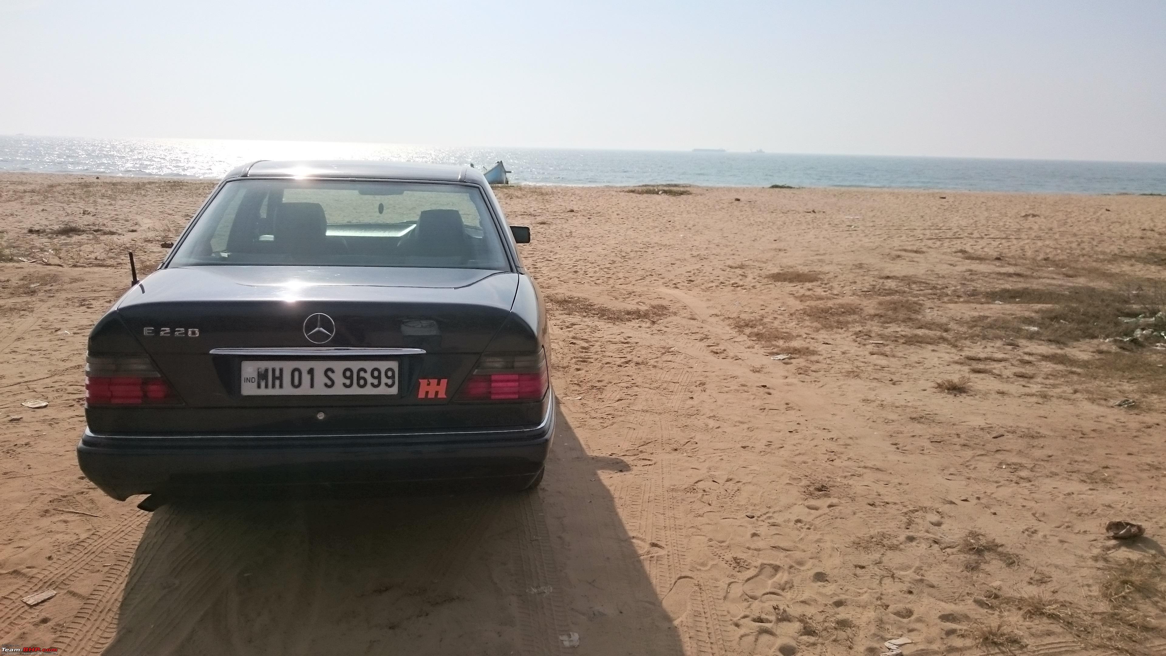

Hey guys, I recently picked up a W124 E220. Drove it down from Maharashtra to Mangalore, had no issues whatsoever till I reached the ghats. That's where I started noticing a whining sound from the back and occasionally, the car would bog down after taking the corners or climbing. It wouldn't stall, but it would hesitate and had to be switched off and on again to work properly. This only started after hitting the corners.
Therefore, after I reached Mangalore, I changed the fuel pump, fuel filter and fuel pipes. The problem still persisted. After a few kms of driving, the whining starts and once the car is heated up, it starts to choke and sometimes misfire. Switching off the ignition solves the problem temporarily.
Could someone tell me what could be the issue, I've even opened up the fuel tank and did a proper cleaning. Cleaned the injectors, which are all fine.
The mech says that it could be the engine crank sensor. But I don't know what causes the whine, even he isn't sure. I read somewhere that it could be a faulty Fuel pressure regulator, could that be it?
First off, congrats! Second, love the CT sticker on the back.
Take a look at the post I've quoted below. Have you had this filter changed?
Originally Posted by abhishek_5 View Post
The thick pipe that draws the fuel form the tank is the outlet from the Fuel strainer and is connected to the strainer itself.
Hence you need to disconnect the mail pipe which is mounted at the base of the strainer itself, which would then give you access for removing the fuel strainer.
Should be simple once the tank is empty. I am yet to get this one replaced.
Viraat13 is offline   (1) Thanks
Thanks a lot mate!
Yes, I've checked the fuel strainer, didn't get it changed because it was nothing like in the picture. It was quite clean, just slight discoloration due to the age.
I've been breaking my head trying to figure out the problem.

Originally Posted by 800Sid View Post
Thanks a lot mate!
A malfunction of the fuel pressure regulator causes issues with starts, if your car is starting fine, I'd suggest you move on.
When you opened up the fuel tank, did you check the breather valve? The easiest way to check the health of the valve is to open the the fuel cap after the car has been running for a while and is properly hot. If you hear a lot of pressure being released when you open it, you ought to change it.
Let's move on to the regular maintenance bit now. Get yourself a can of carburetor cleaner and clean out the mass airflow sensor using that. For the throttle body, disconnect the air pipe and spray the carb cleaner into the throttle body with the engine running. While doing this, you should take the engine through its RPM range to ensure a proper clean.
These two steps may not help in this cause, but they're a part of regular maintenance, so it doesn't hurt.
Do check that the spark plugs are correct. The correct ones are - Bosch F8DC4 or FR7DC+, NGK BCP6ES or BCP6E or BK5KE or BK5KES. Speaking of sparks, have a look at the ignition coil wire. A shorted wire will cause many issues.
Additionally, is the engine wiring harness new? If not, it could be the source of all your troubles.
