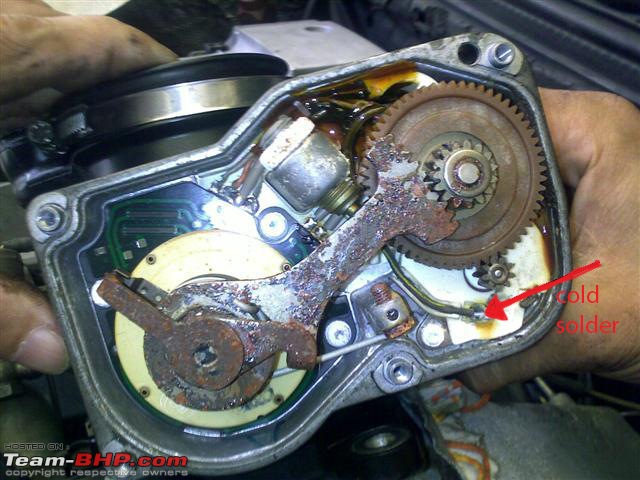

Check your wiring, specially this cold solder spot in the throttle body
