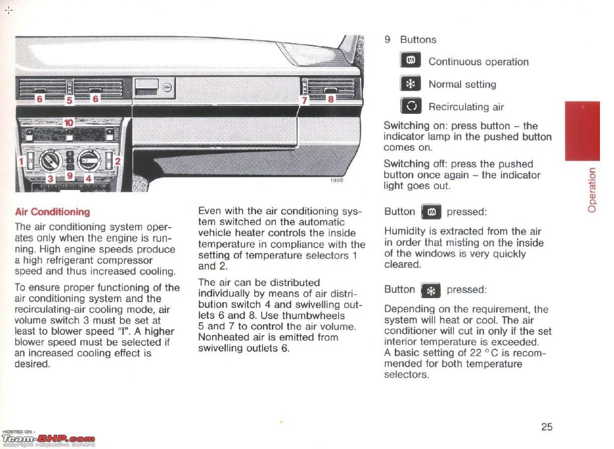

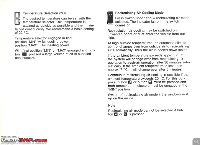

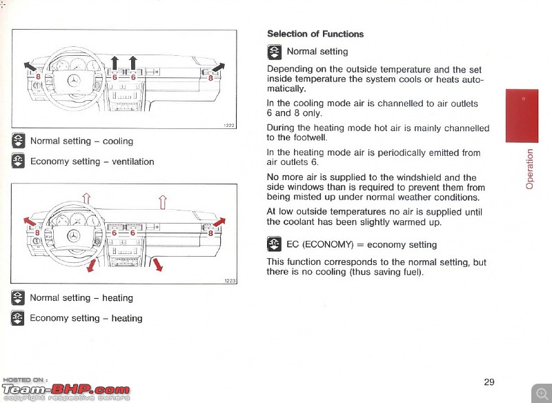

Old 20th June 2014, 16:35   #701
Ray32825's Avatar
Join Date: May 2014
Location: Orlando, FL USA
Posts: 101
Thanked: 69 Times
Re: Mercedes W124 E Class Support Group
Air Conditioning and climate control from owner's manual.
Ray32825 is offline
