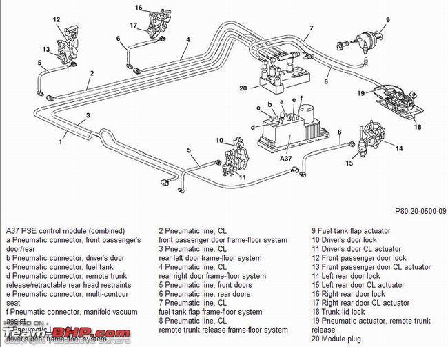

Could any of my learned enthusiast friends on this forum tell me where the vacuum lines for the rear head restraints run? Is anyone able to tell me where I could locate the vacuum line / circuit diagram for the car in totality. I describe the problem that I face:-
The right head restraint releases and drops down but the left one does not. Three weeks ago was the last occasion that I operated the dashboard switch to drop the restraints, the right one released first and then the left released after a delay of a few seconds. Today only the right released and after repeated tries I noticed that there is a soft click heard but the restraint does not drop down and then some tiime later a second click is heard. I suspect that the vacuum connection or the mechanism is faulty / sticky. The big question is how do I reach the lines and if need be how to lubricate the mechanism. Please help pals !
Karadi is offline
I have the vaccum diagram, however its at my home in a hard copy manual and cant access it, meanwhile you can refer to the screen shot from EPC that shows the wire running
The wire is behind the carpet that covers the petrol tank from the boot, lean inside and you will see; do the following
1. Remove the pipe off the offending headrest; ask someone to to press the button
2. Feel for vaccum using your finger, if you feel vaccum then its the actuator that is bad
3. if you dont feel for vaccum then, trace that wire to see where it is leaking
I assuming your vaccum pump works, as the line to the headrest is a common one which split for two head rest
Let me know what you find out; if its the restraint, thenit can also be the locking mechanism or actuator or some small pin etc. Will let you know what to do
Screen Shot of the EPC
Generic part diagram, will send you more specific from my manual if you want in few days
